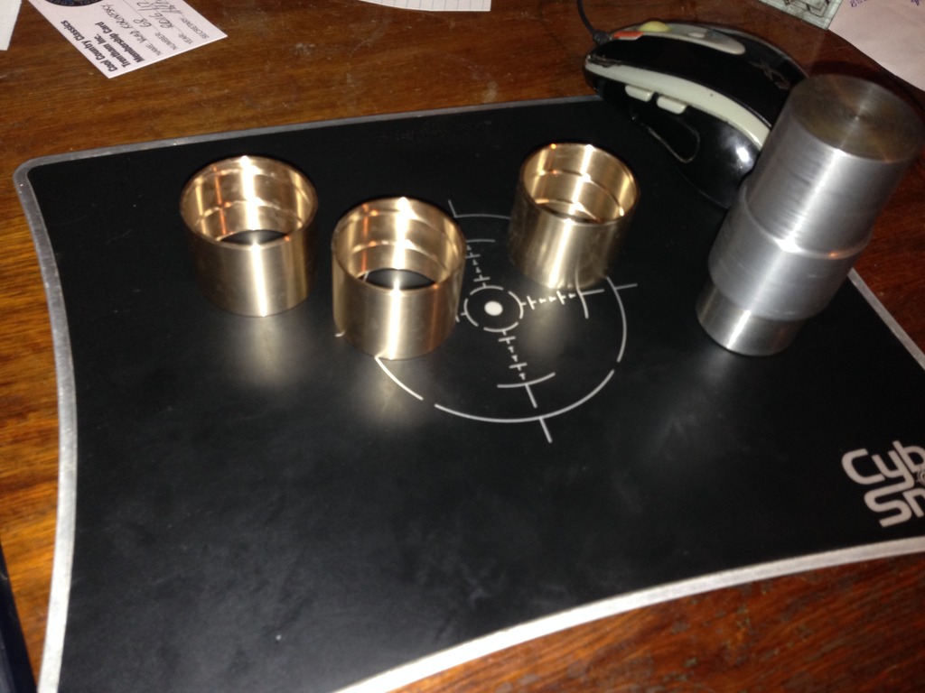

Also I picked these up this arvo, the guy even made me an install tool for nothing :thumbup:
Nice crystalline structure visible in the bronze
Not long now for the T5 :punk: Interestingly the way he machined the tolerance in the bushes is the final ID size will shrink to correct tolerance once the interference fit is made when pressed into the housing. The bushes also have a non interference lead in section to aid initial alignment when pressed.

Nice, looks like quality work which unfortunately can be rare to find these days.
Chuck em in the deep freeze overnight before fitting.

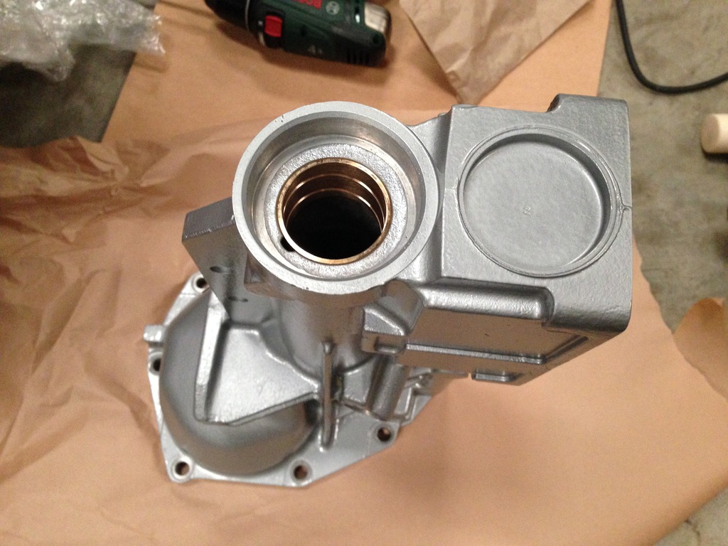

I'm just going to heat the extension housing as aluminum has the higher expansion coefficient. With a 20 ton press, really its not that critical.
Extension housing done. Fitted an old shifter to test operation and A-Ok! :thumbup:
Very firm and mechanical sounding and I haven't get got a decent shifter yet.
