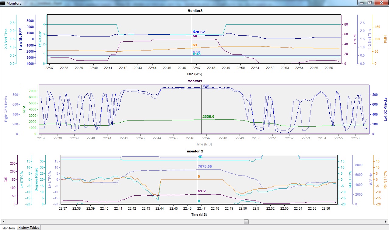

here's my second log, readjusted MAF again for run tomorrow, 7000hz @ 50%tps 2300rpm, ill try a bit more throttle tommorow and see what it gets upto.

Re: 4" intake piping - 95MM MAF Tuning
The MAF frequency is limited to 8191Hz above the minimum/start freq, and yep if you exceed that it just flat lines.

thanks VL, ill see how it goes with a bit more throttle, as like the Throttle Body it may max out the airflow with less TPS so i may not get alot more airflow out of it, i can bump the start round 2200hz mark if need be never seen under that in my logs so far.
