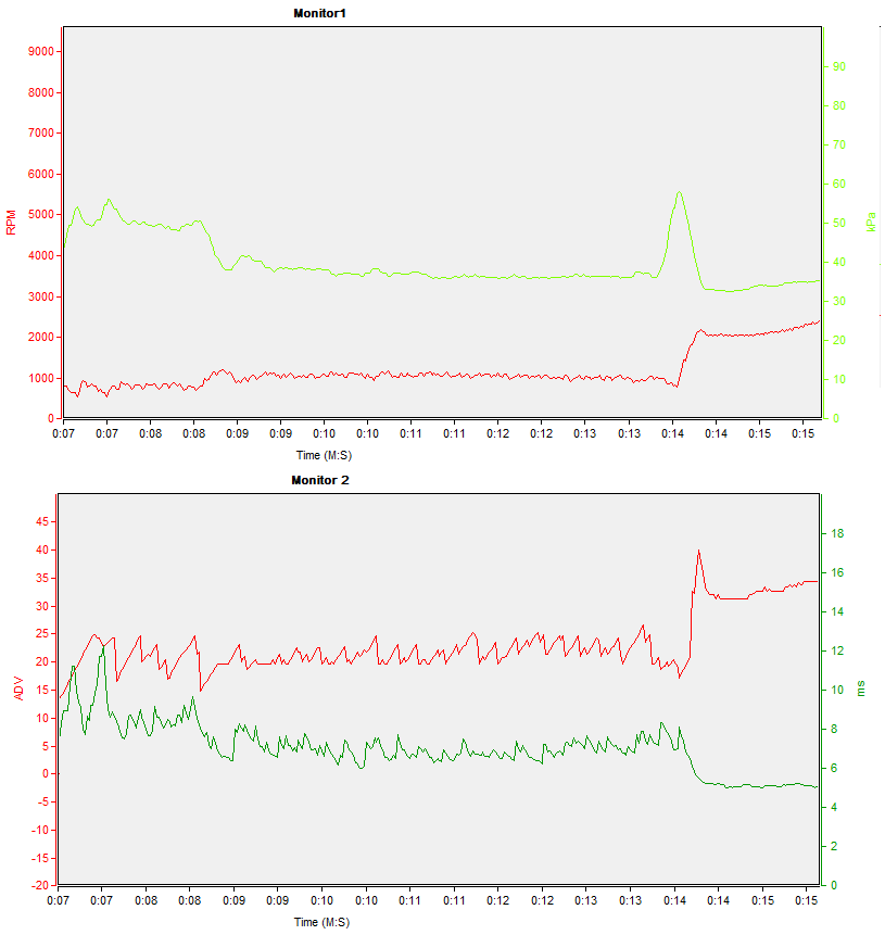

I guess you also need to know if the hall effect tone change is the result or cause - it will change when the engine stumbles but was it the first thing to change tone? However if it works fine on the standard module its pretty unlikely and is more pointing towards the output driving your ign box.
Not getting any EST fault codes reported by the ECU?
Back to your dynamic dwell here is a data log (its about 40Hz so so shows a reasonable representation) showing dwell at idle on a V6 - it was cold and about 1 second after starting it so idle is a bit higher. Dwell is the green trace in monitor 2, the red in monitor 2 is spark advance showing the idle spark control...

Yeah, the dwell certainly jumps around in a hurry, doesn't it? Maybe it's making life difficult for me...
