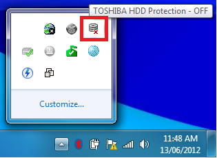

tag one more with no issues, every pc I own has win7 64 and all of them work perfectly logging and tuning. I had a problem with logs pausing and jumping forward on my toshiba laptop when I first got it, turns out it was the G sensor for the HDD going into protection mode whenever the car I was tuning hit a bump LOL. I know it sounds risky to turn it off but with it on you will get a gap everytime the car hits a bump in the road

I Think Jayme has just nailed it
, I am using a Toshiba T130 laptop that does have the HDD g shock sensor
. When I did the 32bit install I have not put that software on
Explains it completely as it was worse going over a bumpy section of road

i think i'm in the same boat, have been chasing down an issue with my brothers drag car for a few weeks, everytime you do a WOT run it would get the first few seconds then flat line till the end of his run, i was miffed .... its never done it in other cars, but then his is the only car that puts enough g's on the laptop with slicks etc obviously!

Excellent find Jayme
Am running an SSD and never had the issue, explains why now!
