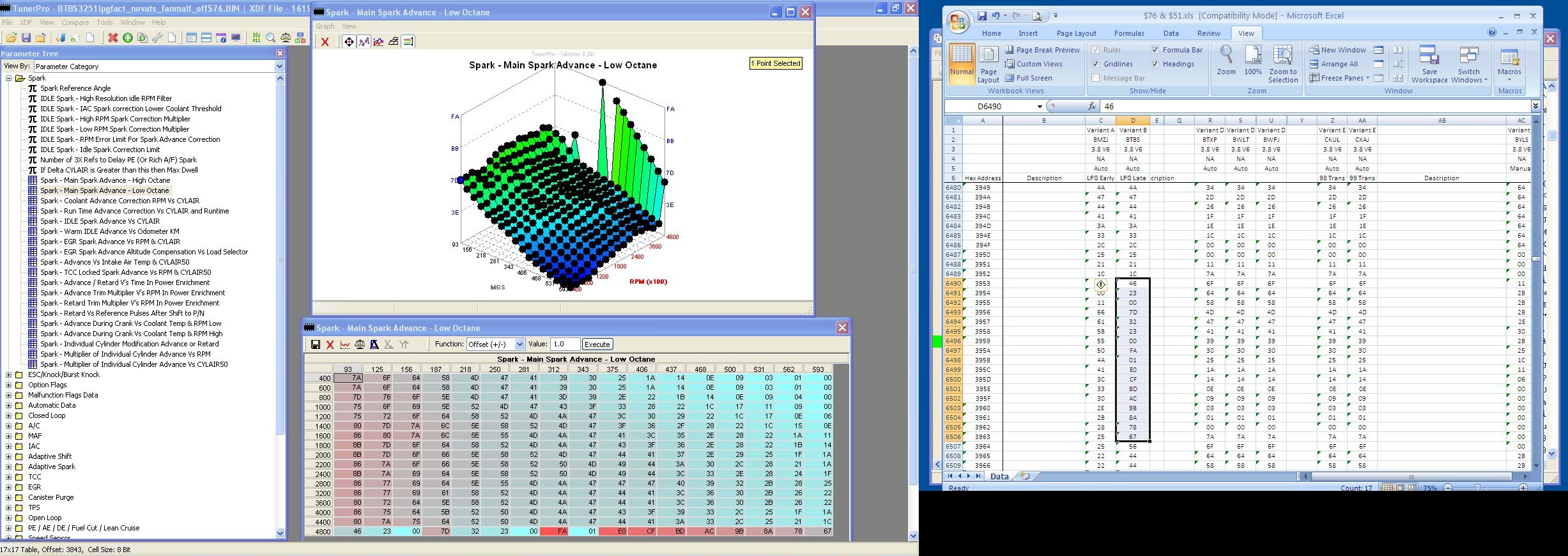

Need some help! What is going on with this spark table, converted $51e to $76b, is the bottom row on the table right? It looks out of place to me.
Yoda, I have compared your spreadsheet to the numbers in the table which are from the1's id tool $51 bin.
I don't know enough about all this yet to make a proper judgement.
By the way what is MGS?

Re: $76A VS LPG input pin
MGS should be milligrams (of air) per cylinder.
The spark table probably starts at a lower address
- Posts: 1217
The 3 bytes before the first value in the spark table should be 00 00 11. The first 1 bytes are to do with the axis start values and the 11 is to do with how many columns of data $11 = 17 decimal.
You can see this in the $51 bins to the right and up a couple of rows from what you have highlighted.
Hope this helps. Have sent email will try and help offline a bit.
Yoda69
EDIT: Just had a quick look and can see the following.
$76A Low Octane looks like it starts at $3956
$76B Low Octane looks like it starts at $396B, has been some addition scalars by the looks of it added/moved from $76A to $76B between $3953 and $3967
Would take a guess at LPG Spark Maps at:
$76A - $3A7A and $76B - $3A8F
$76A - $3B9E and $76B - $3BB3
