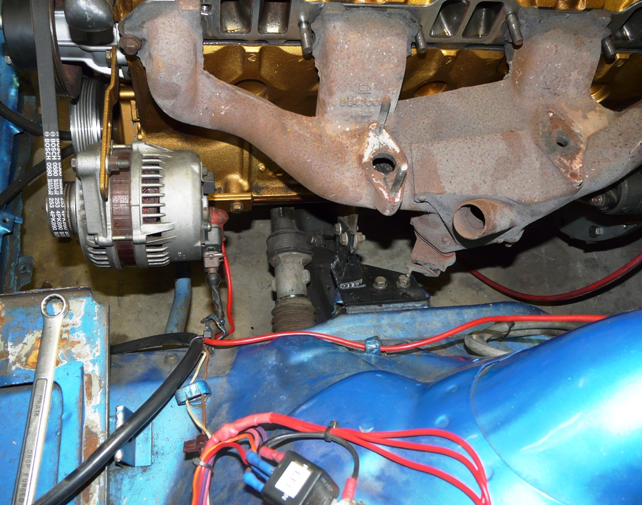

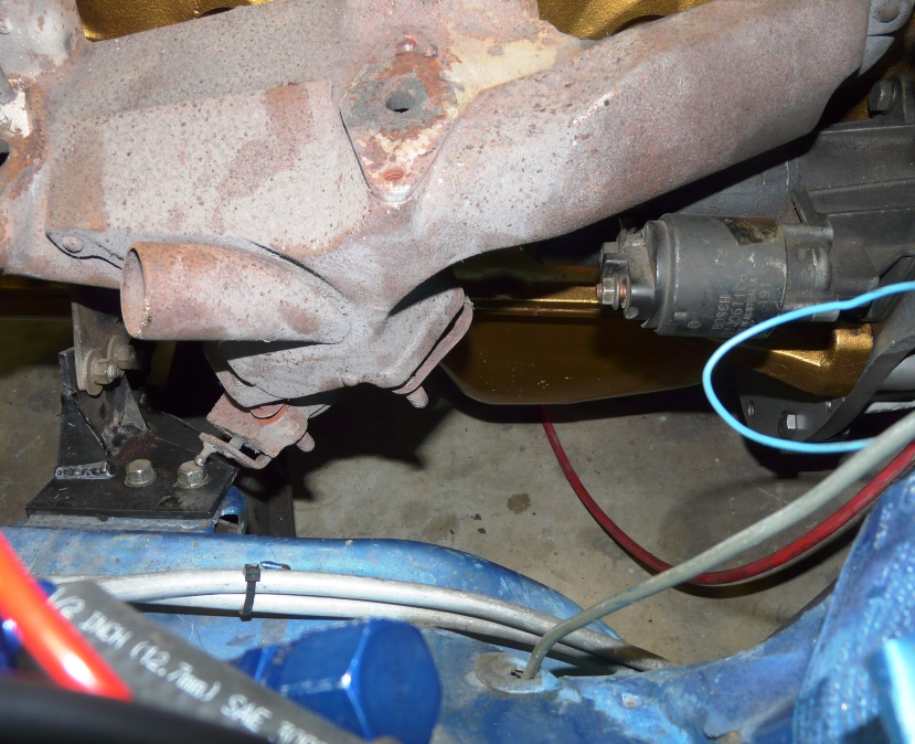

yeah i have tried the cast iron blue manifold, it would work but its not optimal so i'm going to get laser cut flange and make my own that goes under the efi manfiold and forward to where the battery used to be and mount the turbo there.
so the J pipe would have to go forwards under the engine mount then turn up behind the alternator towards the battery box area.

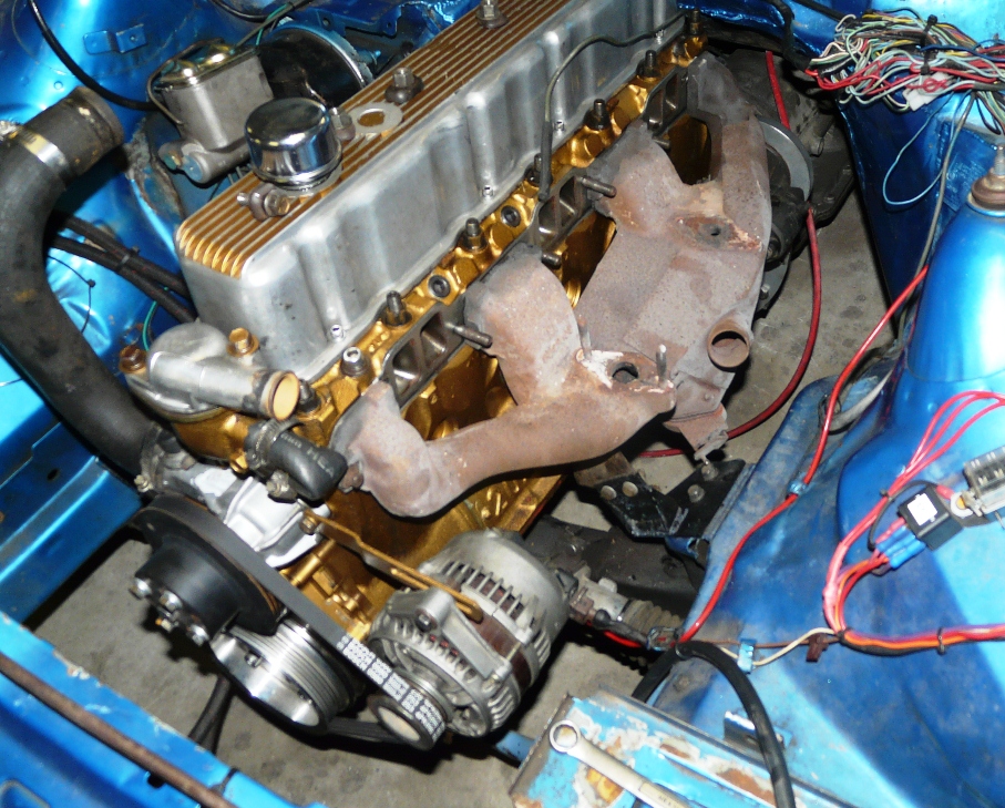

turbo will sit roughly in this area where the spanner and relay is.

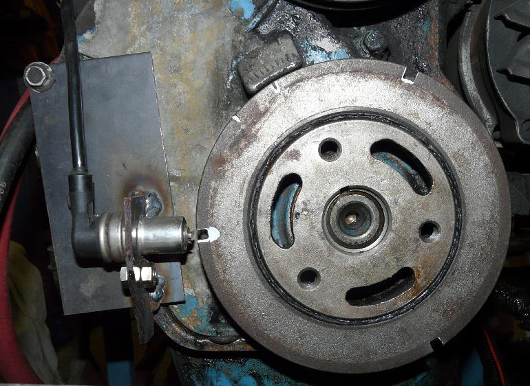

the balancer needs 3 slots cut in it, so get the sensor mounted, get the motor on 10 degrees advanced, then from the sensor, mark it and 2 other evenly spaced slots - this basically replaces the 6 pointed star in the electronic dizzy and fires each time these slots pass the balancer sensor.

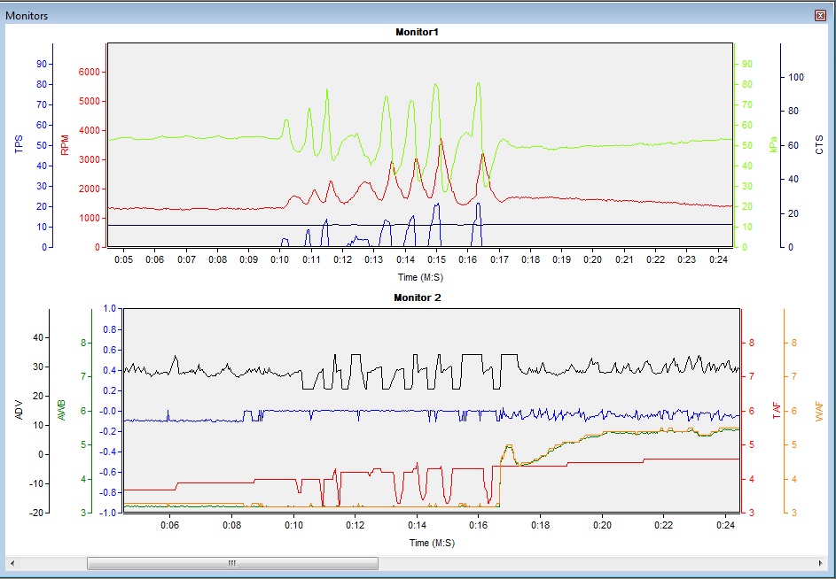

can someone thats had a bit of experience with this tell me if thats too much choppiness in the rpm trace, to me it looks more rough than the 202 dizzy trace was ?
abs sensor first log.jpg (114.79 KiB) Viewed 8654 times
anyways happy with the results, its working and my rough angle grinder slots are close enough hehehe about 6-7 degrees on the diag mode timing light..... you will also notice in the top picture i fucked up cause the TDC mark is on 8 degrees and it should be 10, but thats cause i had to swap balancers and marked it with the balancer pushed on a few mm and did it by eye so i could remove it again to do the slot cutting in the vice! very precise workshop i have hahahahah :wtf:
it also shows though how much the balancer can spin on the inner part, this balancer in the picture has done about 150,000kms on a worked motor that revved to about 6500rpm and it was a powerbond street one which apparently are glued together with the rubber .... hopefully the race one i have on the gemini will be less prone to slip as i don't use its v belt groove at all so no load other than engine acceleration.
my suggestion to anyone wanting to do this mod would be to either buy a brand new balancer and make sure its a good one or make up a chopper wheel to bolt to the front of the balancer that can't slip!

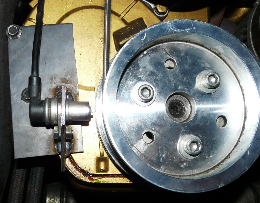

so finally got the good balancer on the gemini motor slotted and alot more accurately too i might add! and put the sensor on the gemini for a test run, seems to work fine, will remove the bracket and gusset it a bit to make it more solid before paint and final install but shes good to go really. Check this log of the rpm trace compared to the one a few posts back up! this is the difference between rough slots and precise ones!

and heres a few quick snaps of the setup - i wanted to get it on the gemini before the weekend so i can test this out at gunnedah drags! and if it misses or plays up i can just plug the dizzy pickup back in (its still all in place) and then keep racing!
