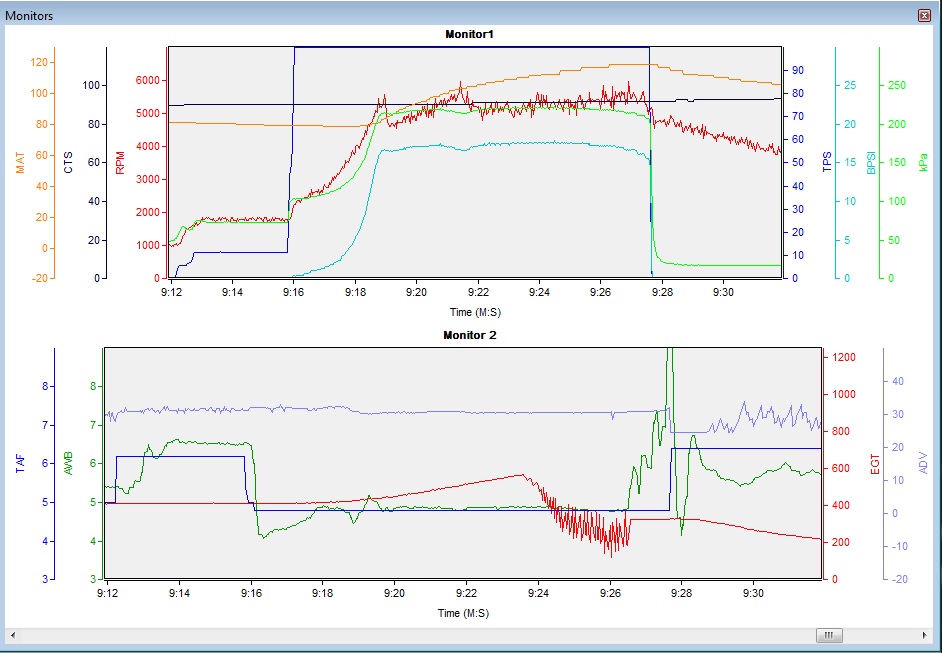

so in the below example,
monitor 2
blue trace = target AFR
green trace = wideband
I know its not the best because its methanol AFR's but you can see at the 9:12 -> 9:16 second marks this is holding the car on the start line on the brake and the ECM is commanding 6.4 AFR (same as 14.7 for petrol) then as the green light comes on I nail it and go through the gears its switched to the open loop AFR table (and in this case also the boost AFR table).
open loop afr is commanding 5 AFR (right on the 9:16 mark) then it quickly drops to 4.8 AFR (boost) and then the wideband is fairly closely following it but there is also a rich spike on WOT (9:16) which I have yet to tune properly.
also disregard 9:24 onwards, I had some electrical issue there.

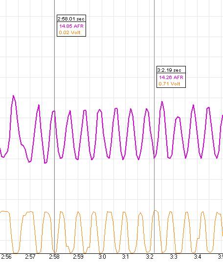

You have lots of unknowns, but there is one sensor that is very accurate at telling you if your rich or lean from stoich - the narrowband sensor. Its been suggested a few times in this thread, use them as a check of your wideband around stoich.
This is from Innovate logworks, Wideband is pink and the narrow band the lower trace during closed loop.. The narrowband drops well below 450mv as soon as the wideband AFR is leaner than stoich and goes well above 450mv when its richer than stoich.

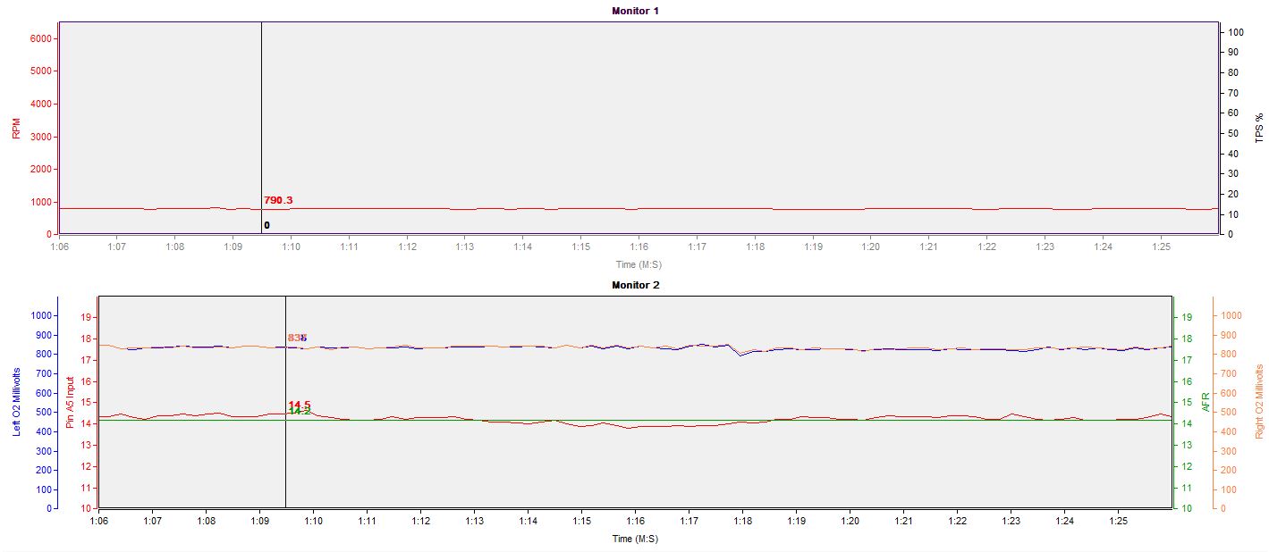

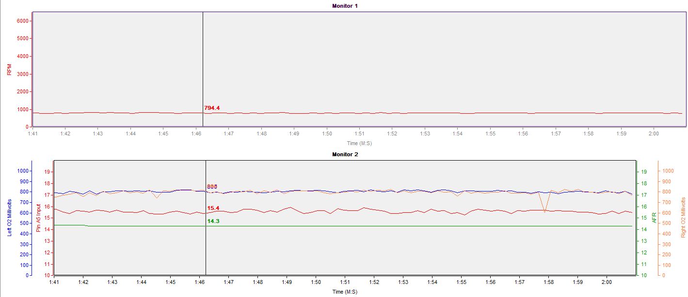

is that from your log?
looking at this trace from an idling log here my wideband is out by heaps- commanded afr is 14.3 (14.25 from idle table) and narrowbands seem to be showing that (not sure their range and the conversion from mV to afr but at least they're showing richer) wideband on the other hand shows way leaner..

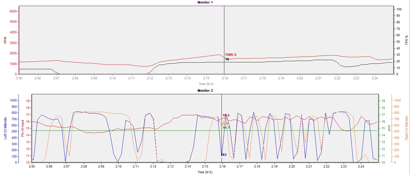

Re: Innovate LM2 Wideband Info
I have a log of that here's another run i did with a long idle period at the start and then normal driving conditions with closed loop enabled and here are the traces
idling- open loop driving- closed loop in this log idling wb afr seems to be pretty close (so its a bit inconsistent with the other log only idling) the driving trace (same log) shows typically the behaviour of the wideband reading- its usually high like that and doesnt really swing either side of stoich its even read 22 (or whatever the max is) before driving on the freeway and coming off the throttle spikes the wideband afr reading to max!!
that does look a bit odd.
i'd maybe suggest running through the free air calibration again just to double check that side of it.
I assume this is a relatively need MTX-L ?
