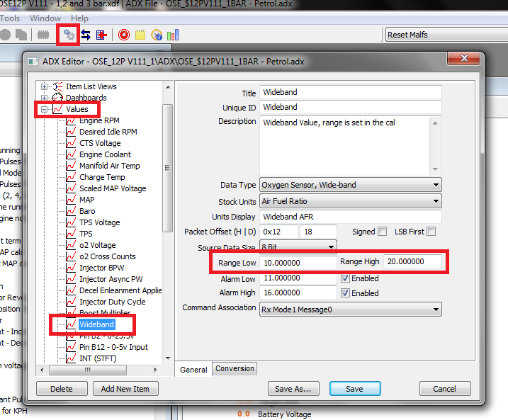

Re: VE Table Help
TAF is target air fuel, AWB is analog wideband, the reason they are three letter abbreviation is because the adx is for VL400's data logger which has limits to length, and the wideband is through an analog input on the logger
To change the adx use the two gears icon up the top then go in and find the target afr and wideband items and when you click on them you'll get the options for range etc ...
Also worth noting this is just the limits of the display, and if you find you can't notice enough movement you might need to zoom in so to speak, so instead of 10 - 18 maybe go 11 - 17 etc

Beat me to it while making a picture, but will post it anyway :lol:

Thanks heaps fellas. The last two posts help a lot. So I should make sure the range is set from eg, 10 - 18 on both the wideband & target afr?
Re: VE Table Help
The numbers don't really matter as long as your graphs stay with-in the limits, the main thing is to make sure both target and wideband use the same values
