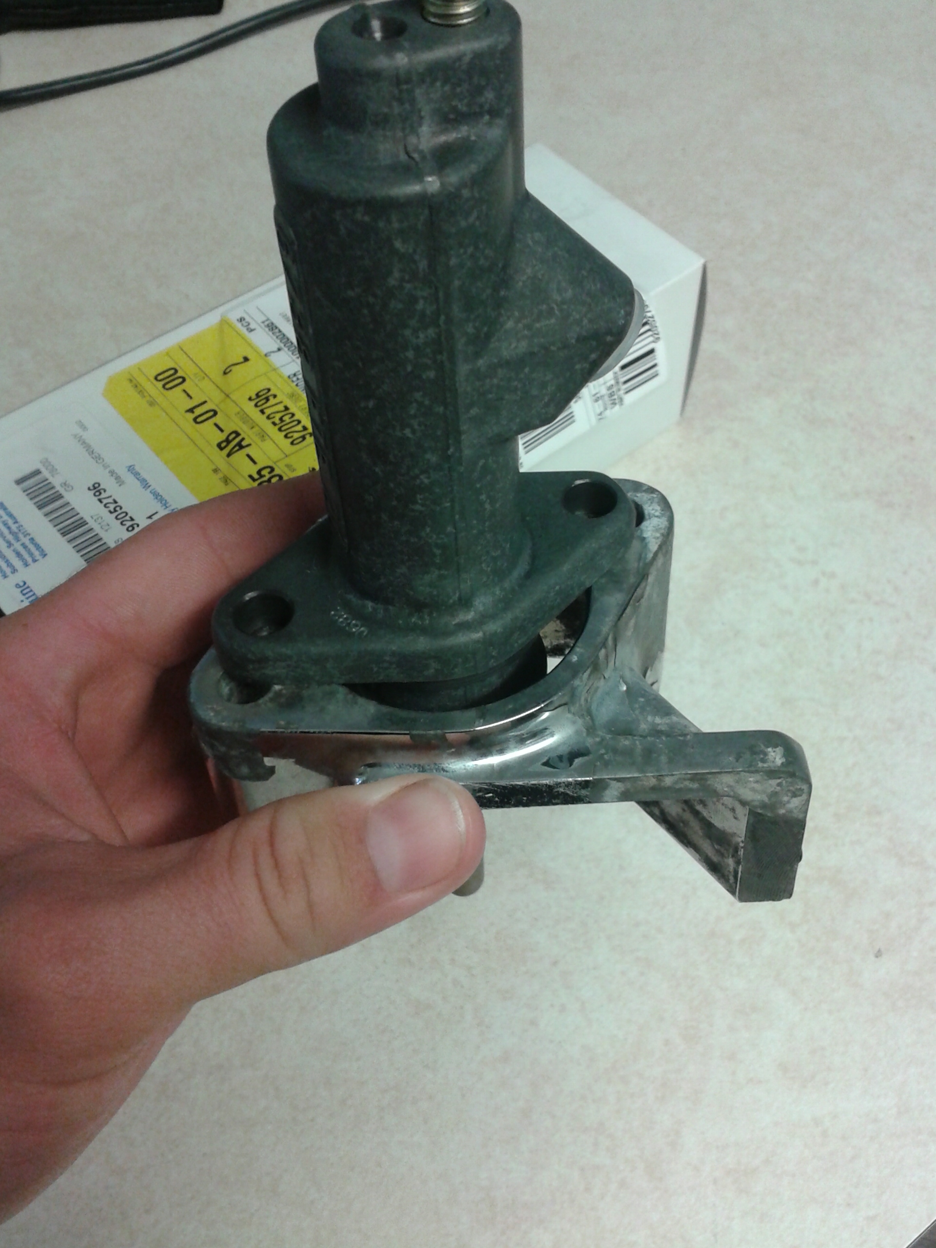

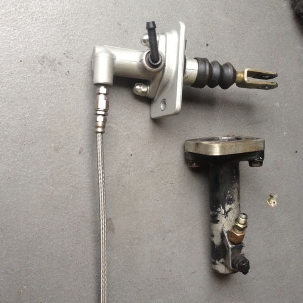

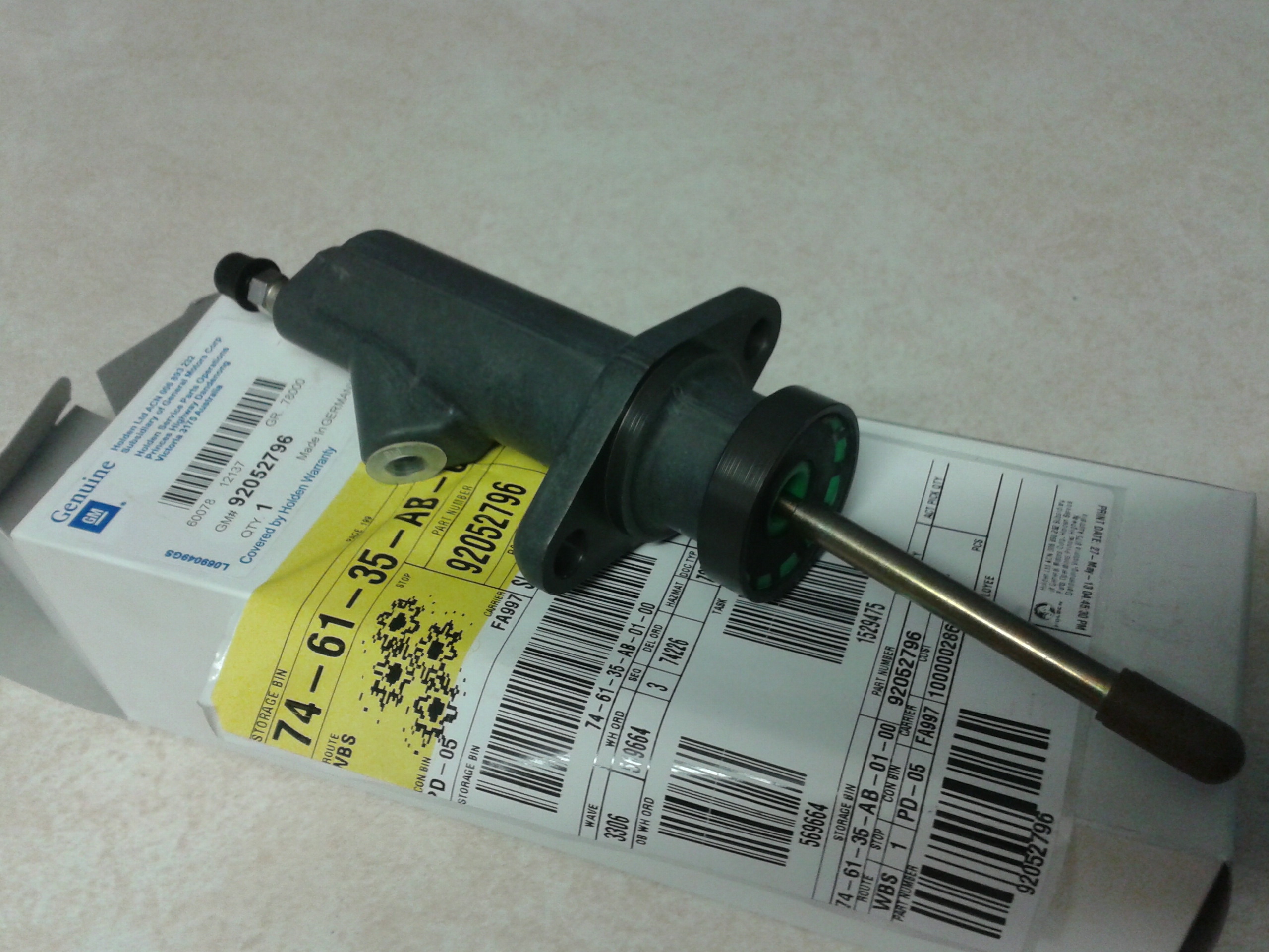

So I have found out the hydraulic slave cylinder for this setup is somewhat difficult to find. Unfortunately the guy I bought the box off lost the slave cylinder before I picked it up, so I went into AmCap yesterday and spent half an hour with the bloke there trawling through their system to find something close.
So this is the photo from the original gumtree ad for the box. Notice it has some form of adapter plate.
Then this is what I bought to play around with, not sure what it is actually from. It was lasted as a vs part and I thought it was a Getrag one, but looking at them they are different. I've managed to find a VIN from a GTS-R with the 6 speed so might have to try AmCap again with more specific car details to see what I can find out.
I'm hoping I can find or get made and adapter plate between the cylinder and the piece that it bolts to then onto the bell housing. Just have to try to figure out the length of the stroke that I need. These pull type clutches are alien to me, I can't even figure out how to get the clutch back onto the gearbox with the thrust race in the fork (yet).
