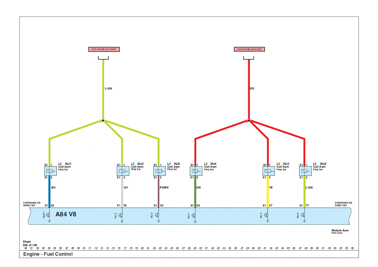

I looked at this a while ago found a 2002 Chevrolet S-10 Truck Automatic L35 4.3 Litre (12212156) wiring and tune file.
It uses only the number one coil driver and low res 3x crank.
this is what I was thinking of using.
LS1 d.gif (91.21 KiB) Viewed 10362 times
DFI.
LS1 c.gif (52.57 KiB) Viewed 10362 times
Injectors.

The 2002 Chevrolet S-10 Truck Automatic L35 4.3 Litre (12212156) is a ls1 pcm and efi live has a custom 2 and 3 bar tune.
The pictures are what I made from the factory ones.
I was thinking the bypass wire should be wired to a 5 volt for the pcm to control from startup or switched in some way.
