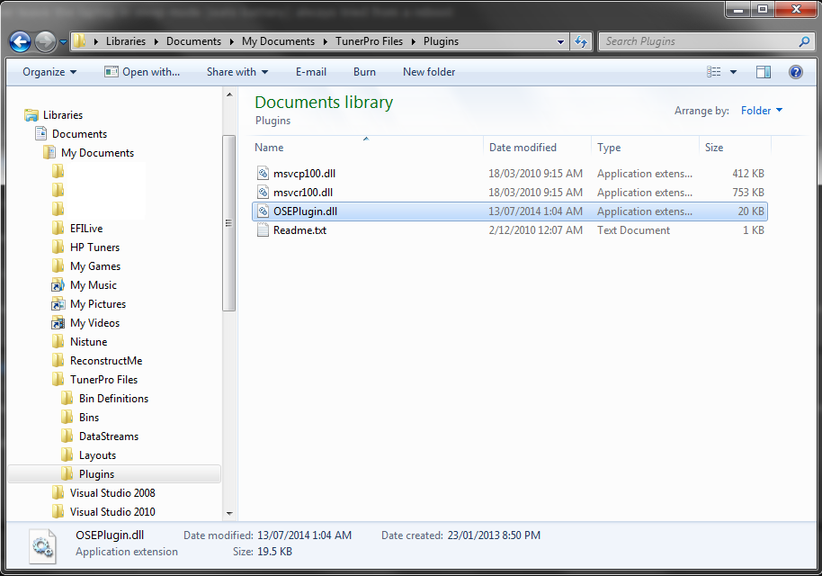

I had similar problems. Initially I had the plugin in the Libraries/documents/tunerpro/plugins folder. I then moved the ose file into the C:\Program Files (x86)\TunerPro RT location and it now works fine.
I'm running win 7 64bit. with the latest versions of Tunerpro RT and OSEpluggin.

- Posts: 10111
Re: connection errors with TP
For the record, that is not the correct loction and not recommended by Mark who wrote tunerpro. If that fixes it - great! But this is more a message to random readers who may find this thread in the future. The correct location is here, and does work on all my win 7 64 bit machines.
