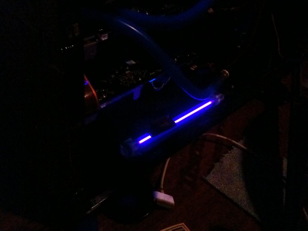

realized that I had UV lamps right next to me. My PC has UV CCFLs so here it goes lol

Can't erase it. tried all my UV sources and they must be not short enough wavelength.
Anyone got any EEPROM I can buy?

I believe festy also tried 400w hid with no luck and theorises the glass must filter uv. He did have success with a tig welders uv though. But for $20 an ebay eraser might be worth buying. http://pcmhacking.net/forums/viewtopic. ... hid#p14851
And/or i can spare a winbond eeprom or two that'll suit. Pm if interested.

I checked out the spectrum of HID, it drops to nothing at 380nm. The glass is designed to block short wave the arc lamp makes.
I can buy a germicide fluro tubes for around 20 buck. basically a normal fluro without the phosphor coating. 245-275nm they are, which is perfect.
I will worry about that some other time.
