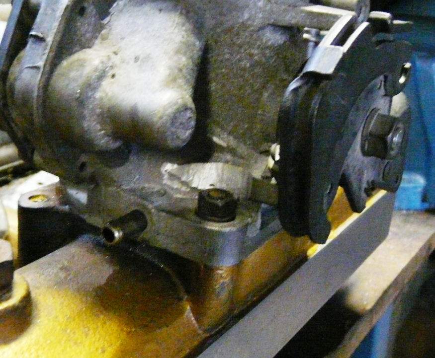

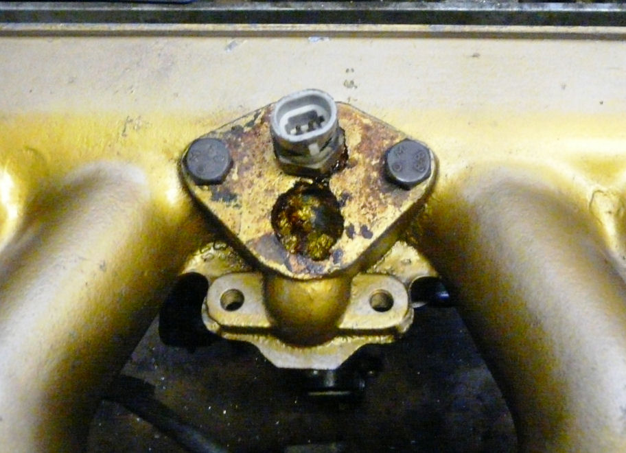

rightio, i've finished the vk manifold with vn TB bolted straight onto it .... heres some pics for anyone that interested in it.
ok first up ... when i did the last manifold i put the MAT sensor beside the TB and it required welding up the hole then re-tapping it for the MAT sensor.... so i got thinking and came up with this location, uses up the EGR valve port which i previously had blocked off and is pretty much the perfect size once you rip the EGR pipe out of the manifold the view from the inside, just happens that when the thread bottoms out in the manifold the inside is perfect and only has the plastic part of the sensor sticking out! Also as you can see its directly behind the TB so its going to get plenty of air to monitor! ok so this hole was drilled out a bit and then elongated about 2mm and this made the inside hole line up almost spot on with the manifold. i had to relieve the area around this bolt but other than that it works alright.

Re: How to convert a 202 to Delco
that was the whole idea of the above mods, the actual manifold has only been modified in the tapping of the thread for the MAT sensor, my original manifold had the square 4 bolt flange ground off and then a commodore 2 bolt flange welded onto it which then allowed the standard commodore TB to bolt on ....
this method allows it all on with only minor modifications to the TB which as far as im concerned isn't an issue as i have these TB's laying around
the other reason for it being this way is so the butterfly is on the top of the manifold as being on the side requires mods to the accelerator bracket .... i could see an adaptor working fine though and i guess if you made it thick enough it would probably allow the accelerator linkage to be on the side and clear the manifold .... which then would mean no need to modify accelerator cable and / or bracket.
with the right tools i did all this in the shed in about 2-3 hrs and honestly you could chuck the TB on without the porting ... in most areas there was 1mm or so of lip which from what i have seen is not very different to alot of factory setups .. but seeing how this is my good manifold thats been port matched to my head and so forth i want it to flow good! never know, it might be on the gemini one day for some strip action
