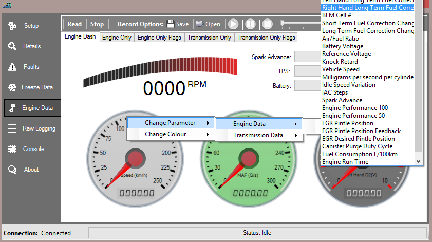

Sooo Iv been putting away in the background putting a dedicated application together for the ALDL ecus. Which has (hopefully) helped me understand the difference between them all.
After going through all the adx definitions and information I can find.. so far Iv found...
VR V6/V8 use same definition
VS V6/VS V8 'can' use same definition
VT V6/5.0L V8 and all S/C vehicles use the same definition (based on what I understand of: A5 Engine and trans TP5 v105.adx
VU/VX/VY flash V6 use the same definition
Only thing Im stumped on.. is what do VS Series3 V8's use? Are they still the same as the VS definition? I keep reading they are different but based on the provided definition file there not different?: VS 3 A6 Engine and trans TP5 v104.adx
Interesting to see that not a whole lot changed between them all.. they all grab similar information between all the models.. some parameters missing or new things added. :thumbup:
Currently, I have it setup so that all the front gauges can be simply "right-clicked" and changed. Including colour schemes ect which will save for next times use. Each vehicle type (VR,VS,VT) will all have separate "saves" for the gauge setups.
The freeze data is a work in progress. Iv got routines down for VU,VX,VY (And hopefully VS and VT if they are the same but different Device ID). And the module details is still a work in progress... got no idea how to address this on VR and VS.. hopefully they do something similar?
