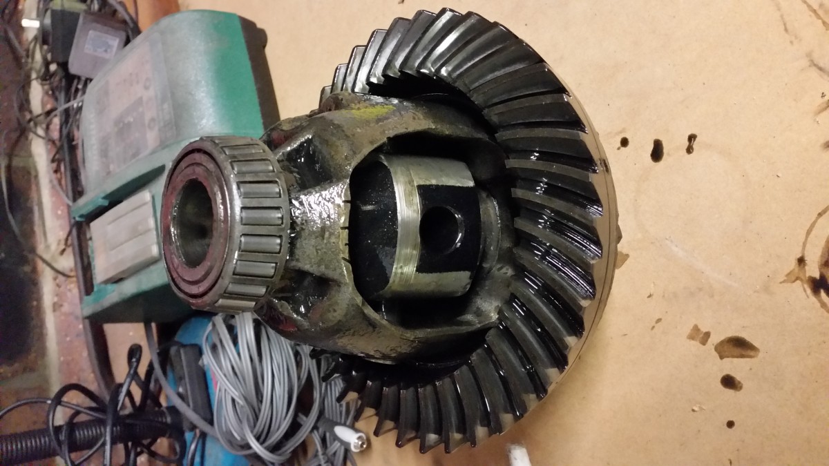

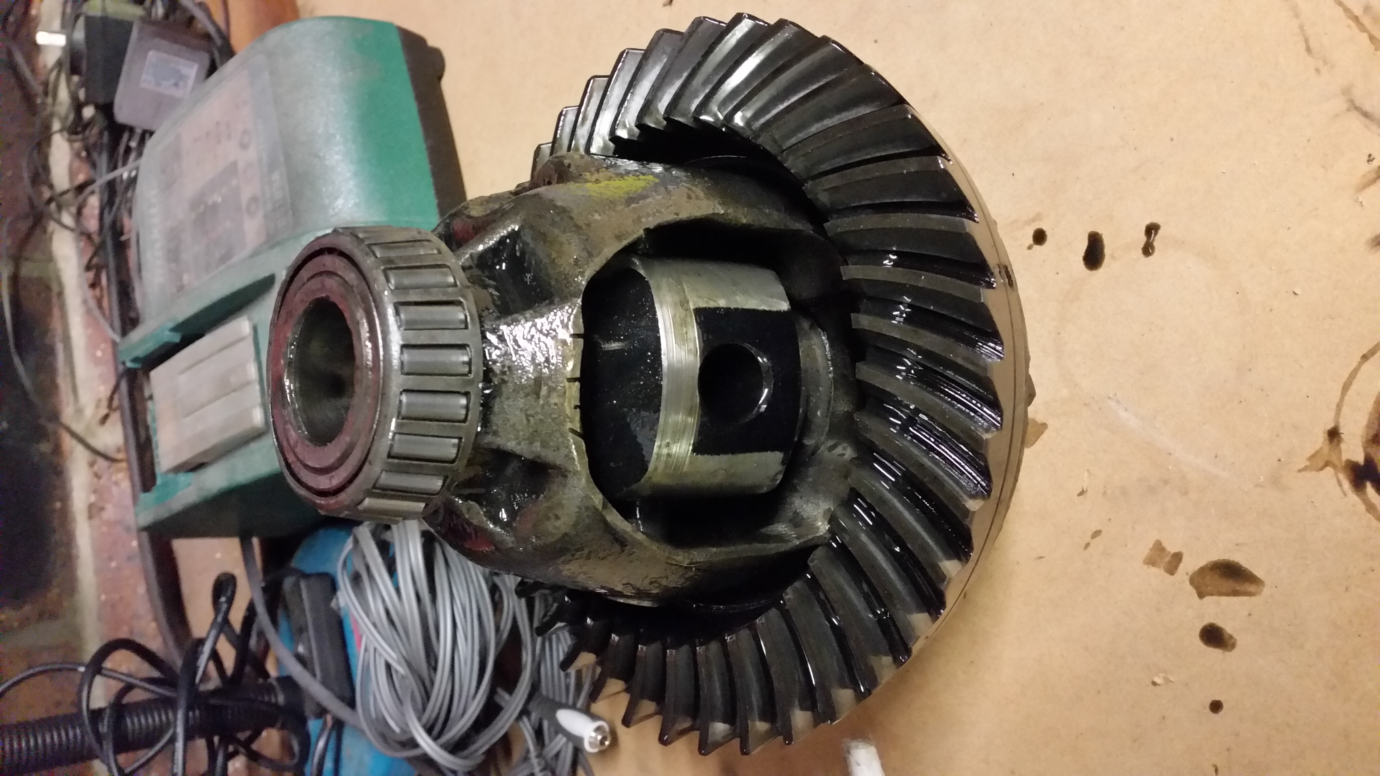

Thought id throw a little info and pics of the diff while its apart
Ive used standard gemini diff but after about about half a dozen snapped axles had to try something on the cheap to strengthen it, so on the phone to engineer friend and put passed him using a borgwarner mini spool inside gimini centre and get commo axles machined down and resplined to suit

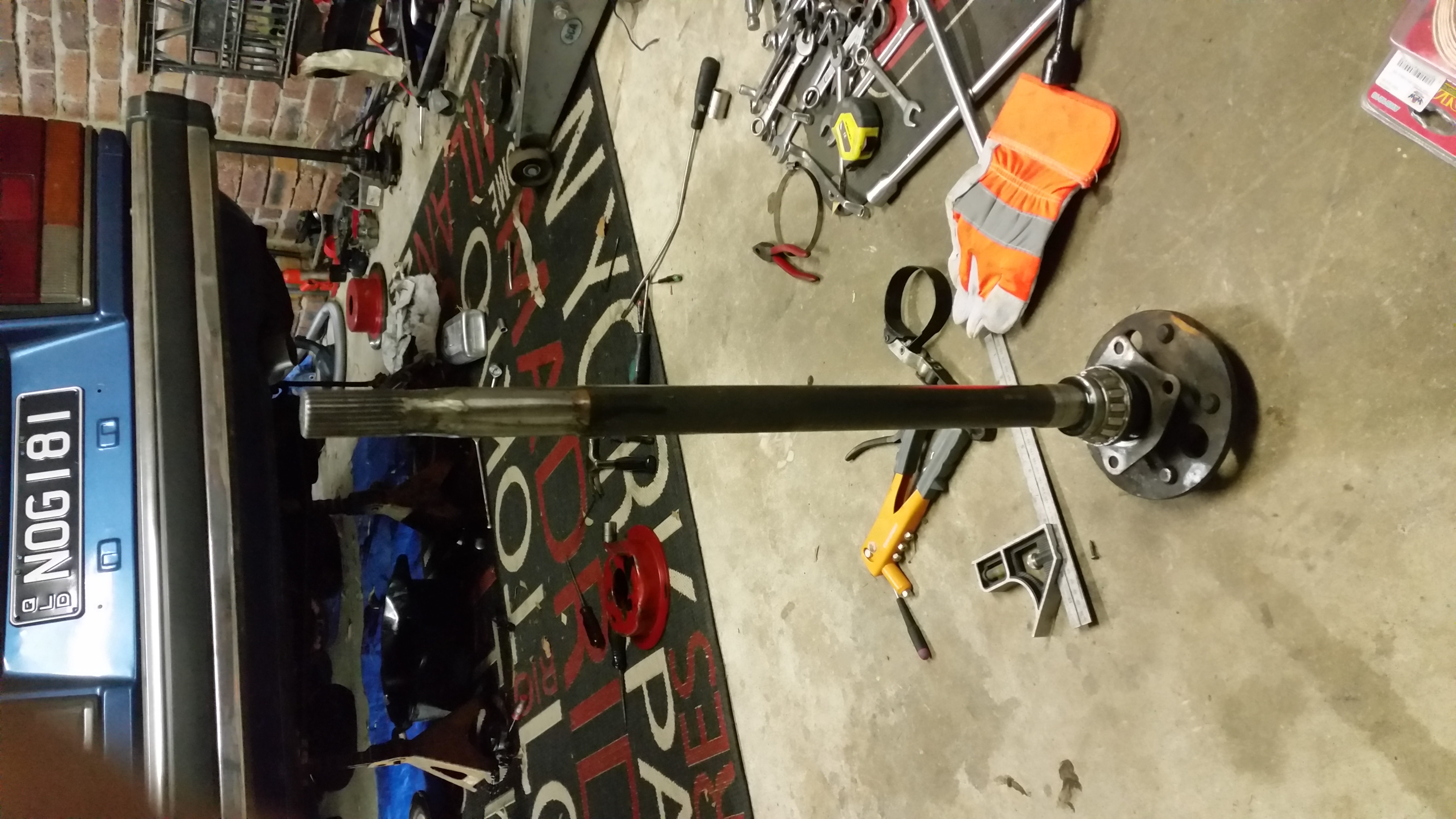

Here is an axle that was made to suit, just used 28spline commo axles shortened and machined down also resplined to 25 spline to suit mini spool, i used gemini bearing and axle seal, gotta love holdens interchangeability

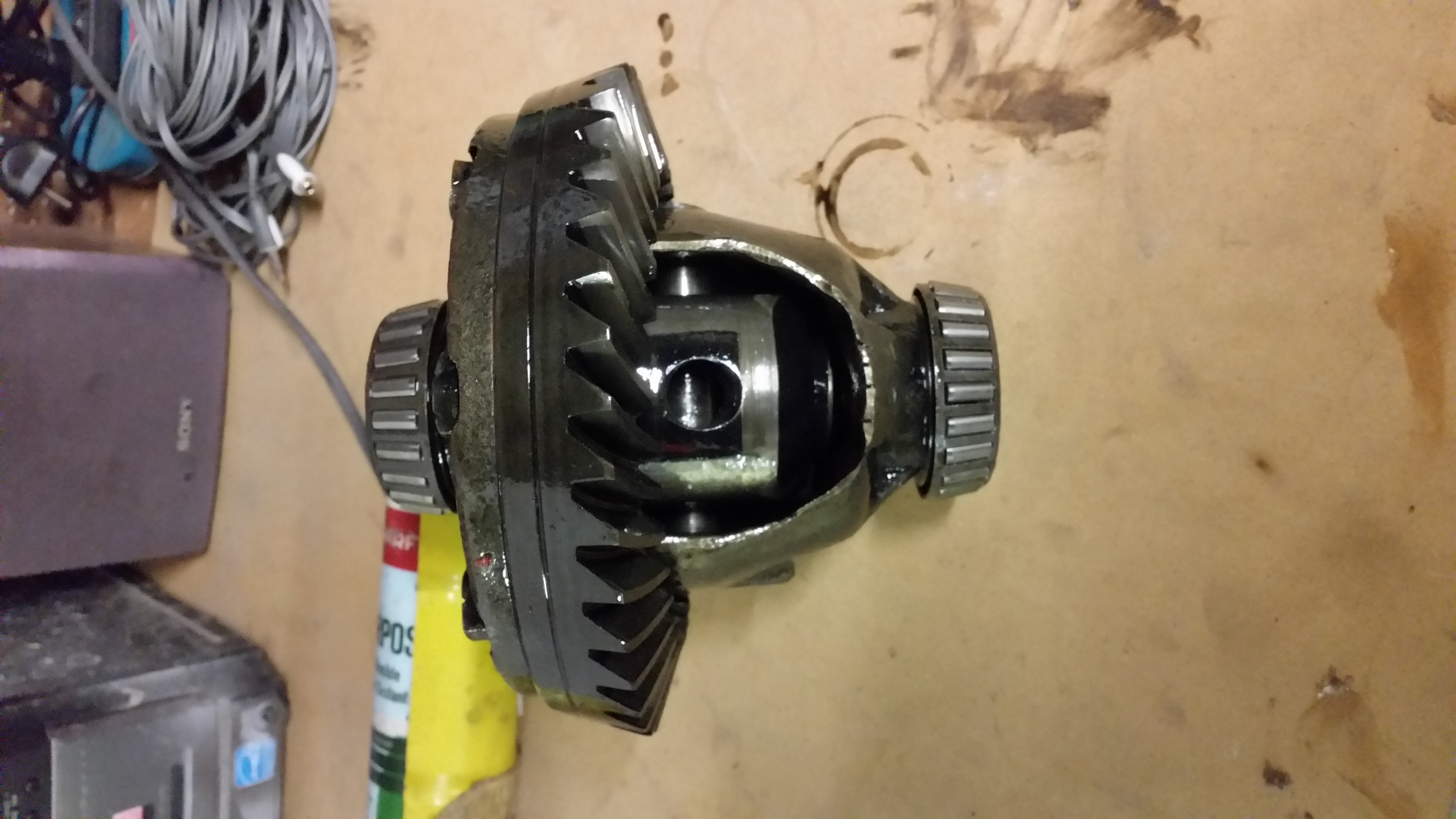

Quickly just slapped it together before putting in, make sure shes all sweet

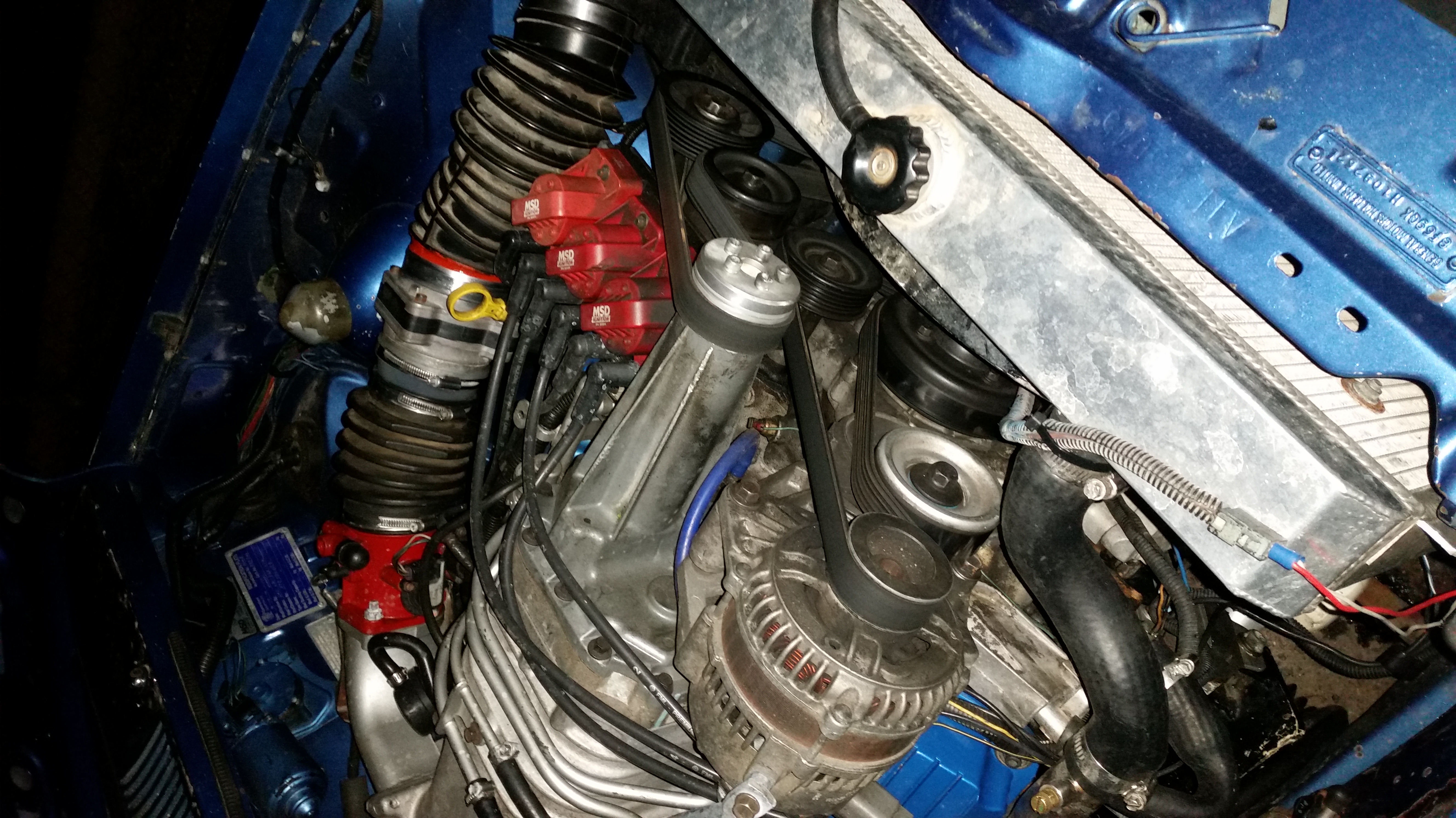

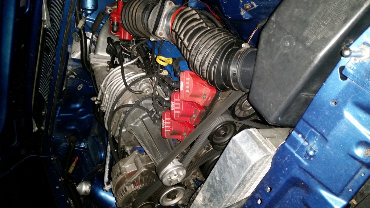

Finally took a couple of pics with the 19psi of love pulley and ls1 maf fitted, just waiting on nvram from the The1 with his enhanced tune equipped then a few little changes etc in which hopefully he can assist me with and will try get the full 19 pounds of goodness out of it, shouldnt b a drama considering with stock maf was getting 17psi on a cold night

I reckon those axles could break at the machined down part since the twisting will now concentrate on the thinnest part. Also the stock commodore axles have rolled splines not machined ones which are strong as it effectively forges the splines.
Was there a reason why you couldn't have used 28 spline center or spool? Oh yeah and spool would add to the stress of the axle. I've seen plenty 28 spline break from the spool alone in stock cars due to the twisting in opposite directions during turning.
If it was me, I'd get a trutrac center with axles made up for it in 28 or 31 size
