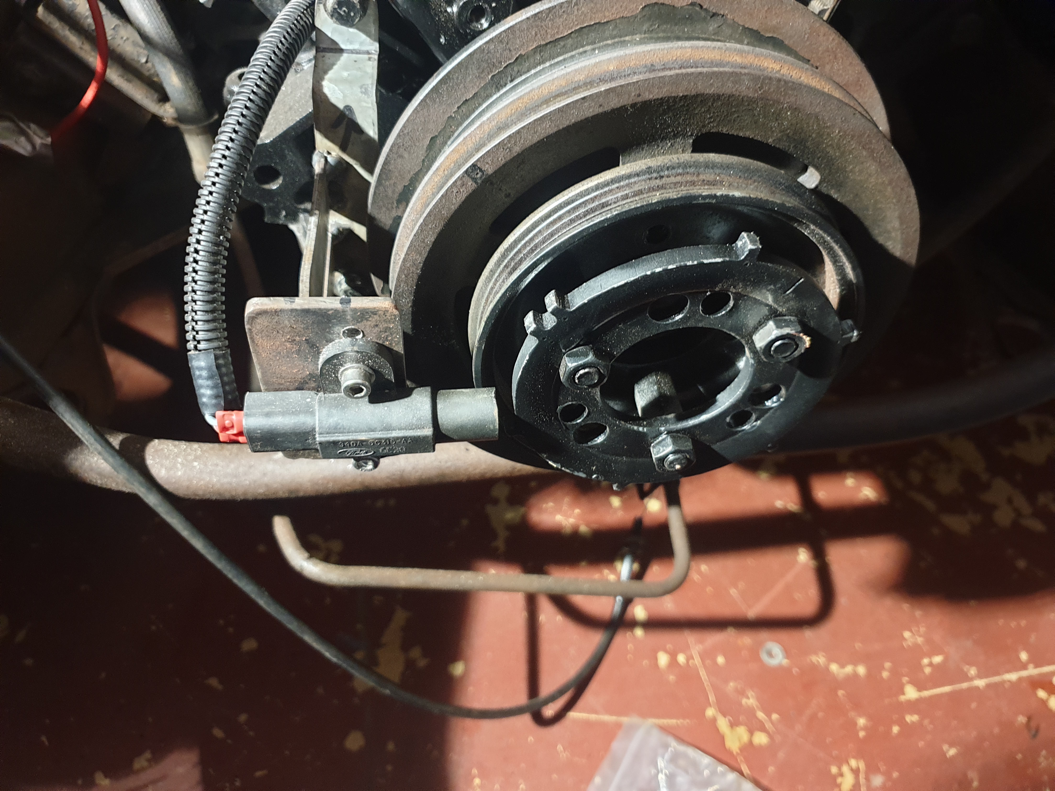

I used a modified EL falcon 6cyl crank wheel and CAS.

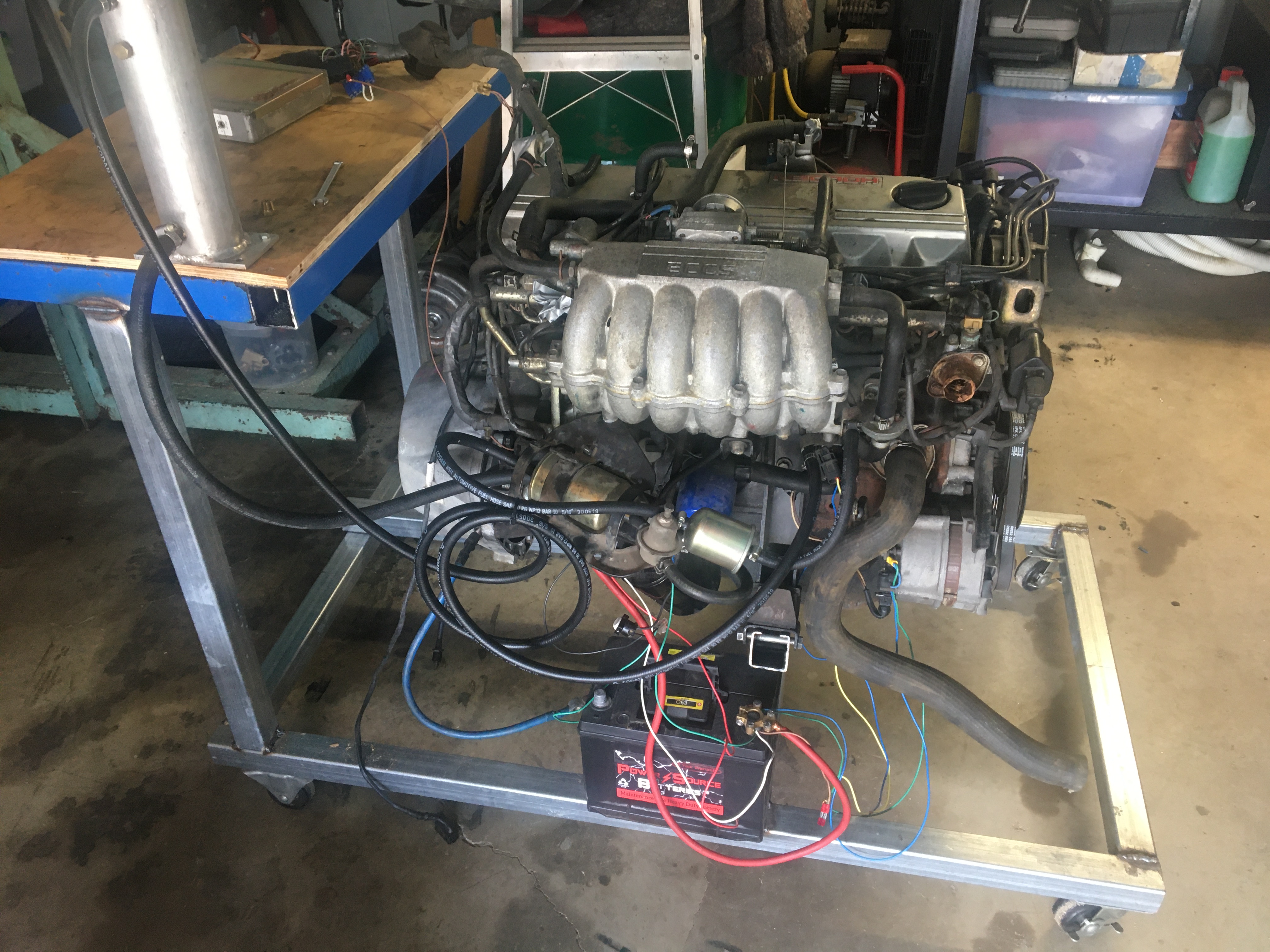

I did have it running on a modified dizzy and v8 module a few months ago while I was looking for a Jackaroo module.
Its pretty slap up at the moment but it will tidy up with a new plenum and some other bits.
If you want to tune the factory VL computer you can socket the memcal and customise a tune. I did this initially as well but there isn't much to play around with in tunerpro. And I wanted to get rid of the AFM.

Ok , anyone want to know what a RB30 sounds like with no exhaust ,no AFM , here it is ...
https://drive.google.com/file/d/1DWbnog ... sp=sharing
Not bad ..
So ,next thing is to strip wiring harness and sensors and look for a gm harness to mod.

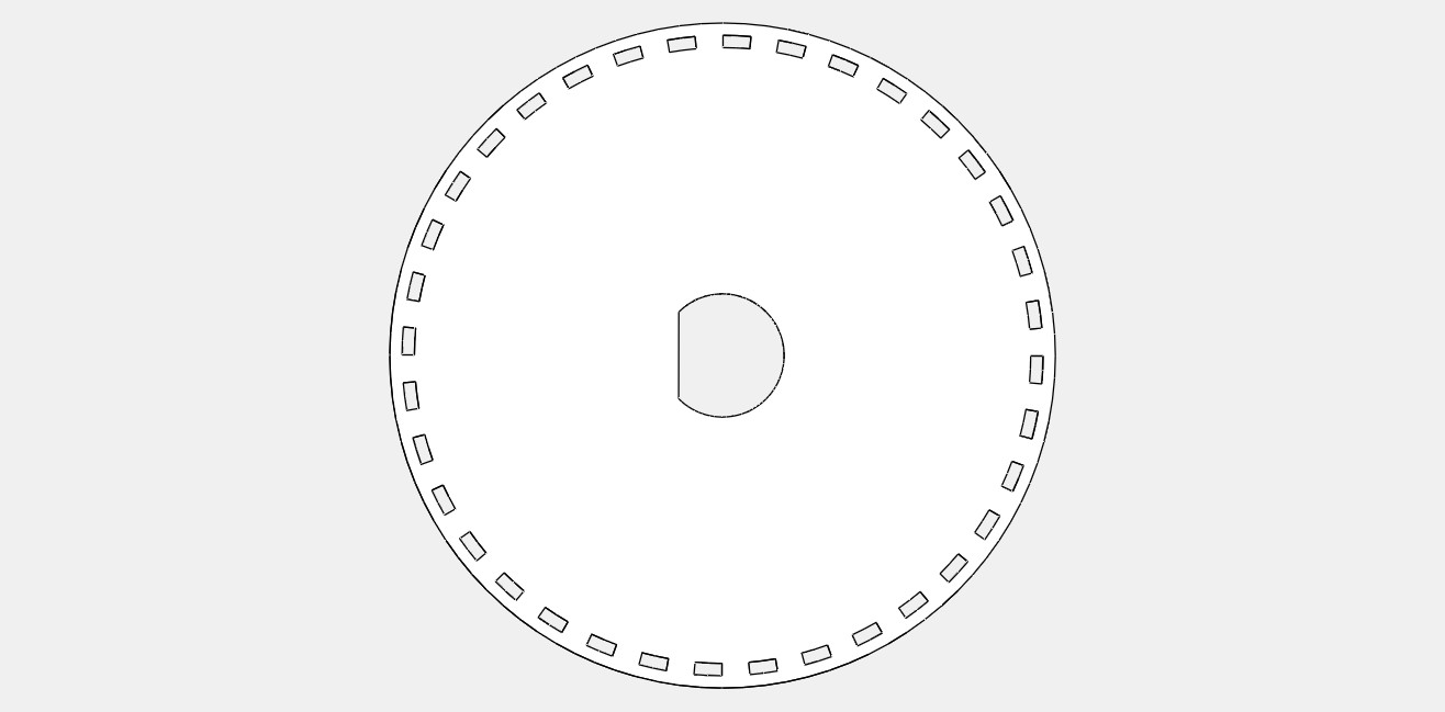

All good mate thanks for the info. My plan is to use the RB30 dizzy (cas) and make up my own interrupter disc . I have been playing with emachine shop CAD software . Never done any CAD work before so getting there slowly. I have a CAD of the disc with the 2* 18x around the outside now i have to get the position right for the 3X . The outer and inner ring trigger beams are different spacing than the commodore so i have some figuring to do.

When the wheel is finished it will have 36 5deg seperation and 6 cam signal . every crank revolution will see 18 *3 of the cam wheel.delcowizzid wrote:18/3 won't work in the dizzy the dfi is expecting it every 360 degrees putting it in the dizzy makes it see it every 720.
every crank 10deg is 5deg of the cam wheel.
