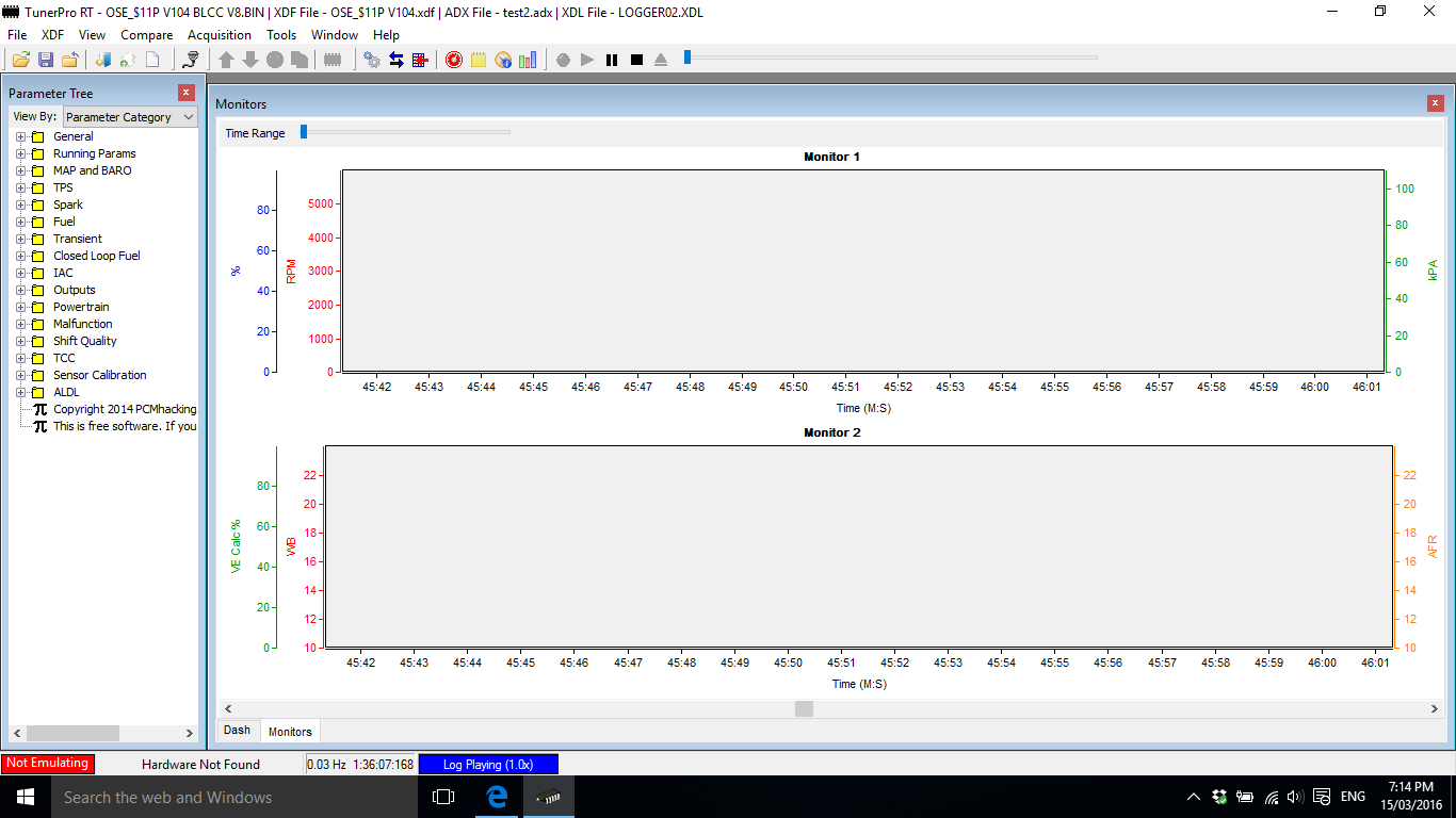

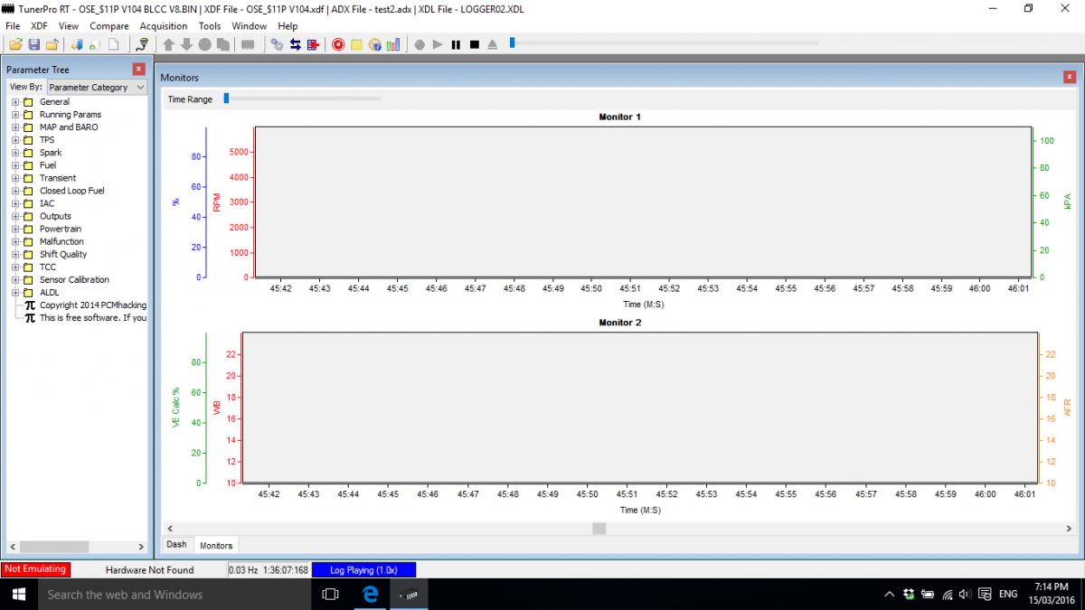

I've attached a screen shot, I ran Jayme new test2 adx but still the same for me. I opened both the log's from the previous page but they wouldn't play any data for me. Was I supposed to do anything else besides load up the new adx?
- Posts: 3823
- cars: VS,VT,VX,VE
Re: Logger V2 11P ADX
I've had issues with no data showing in the monitors screen on replay. Try rebooting and reloading tunerpro, reload the ADX and then try it again.
yeah ... sorry, I loaded one of my own logs by accident not yours.... yours still doesnt work
ill keep looking.
