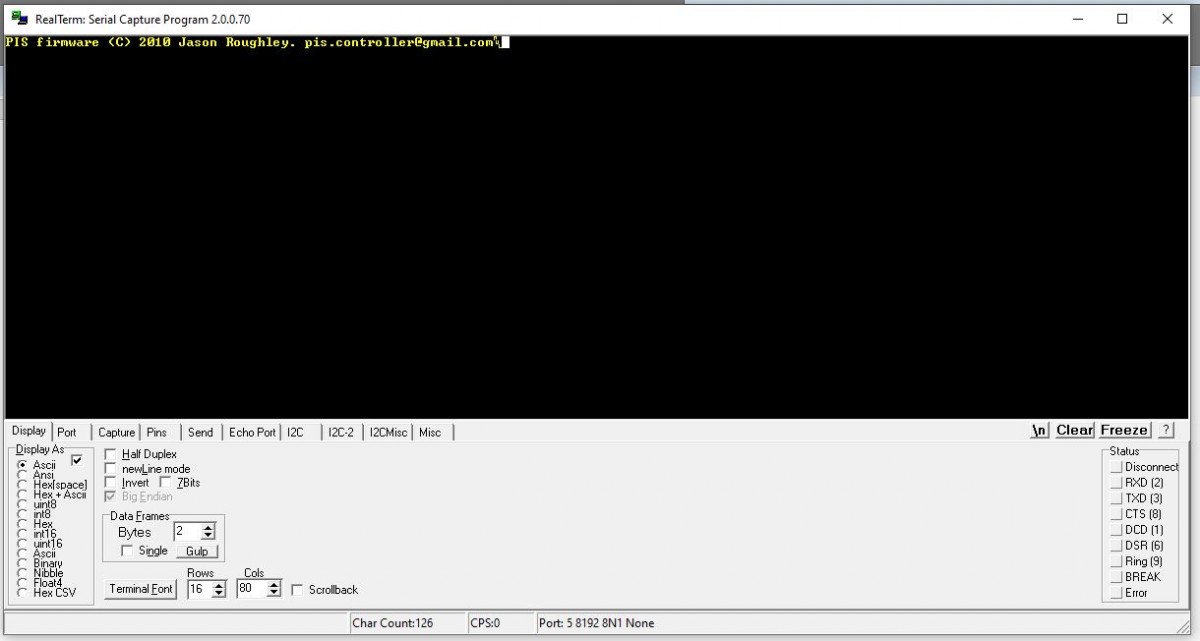

Just found this great piece of software last night! Spent some this morning fixing the serial routine and now you can connect via a terminal and send S to get 'PIS firmware (C) 2010 Jason Roughley. [email protected]' back. Now we have a working comms link!
I've bench tested it and both ignition and fueling signals seem correct and vary with map and rpm as expected.
Just need to adjust the tunerpro connection command and we'll be able to read/write to the cal.
I've attached everything you need to compile this source on a windows machine (I'm on win10). Instructions in the txt file. I've included GCC and Make in there.
I hope the respective owners don't mind the post here! I'm not sure how to update github but if anyone wants to do it for me or walk me through it, we'll update the source to include the serial fix and adx fix. Can't wait to see what becomes of this!
