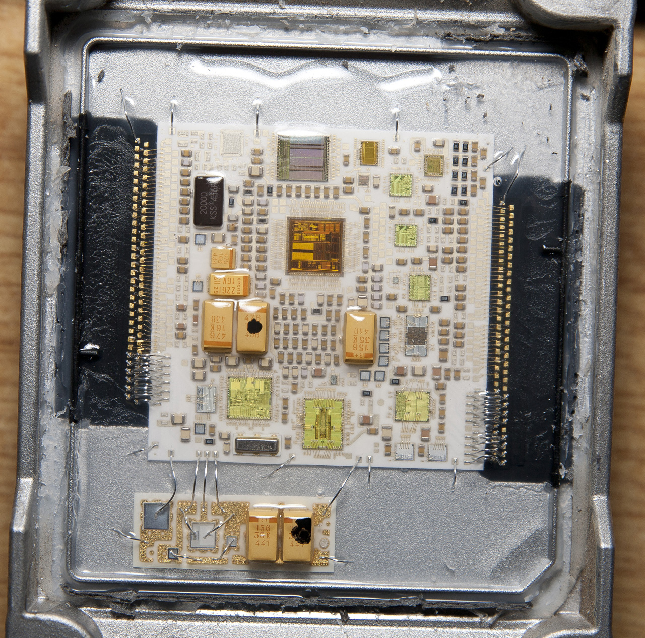

Im talking about this type of stuff:
http://m.youtube.com/watch?v=kynXjan7O0Q
Ive not done it, could be wrong, but I thought it was the go for bosch pcm work. Certainly no silver bullet but i bet you reset one pcm, then melt the glue (much worse than in this vid on the e55) then read the flash, the repeat on another pcm to write and reset it back to unprogrammed state. Far from easy, but none the less....

nope

The1 wrote:nope
:lol: :lol: :lol: :lol: :lol: :lol: :lol: :lol: :lol: :lol: :lol: :lol:
Thats the one
Re: vz v6 e55 ecm vats reset
that top silicon die, the qg-4x comes with an adapter for that.

vlad01 wrote:that top silicon die, the qg-4x comes with an adapter for that.
really? mine didnt
lol, was just kidding. No way anything on the human scale could connect to that lol.

Post by ejukated »
lol yeah I was thinking WTF. only way you could do something like that would be a BDM jig with very precise positioning.

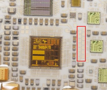

It wouldnt surprise me if bdm or jtag was on the staggered connectors to the right of the main chip. Wouldn't be easy to connect but i'd be surprised if it wasn't possible.
VZ ECU header.jpg (35.01 KiB) Viewed 5734 times

That would be one hell of a mission.
Im staring at it right now.. and to even get through the top layer of gel is seemingly impossible.
