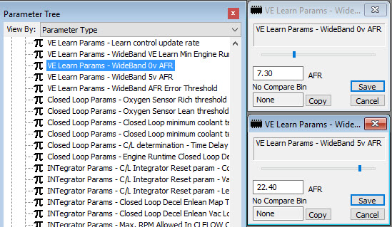

have you adjusted the 0v and 5v wideband settings in the tune to match what the wideband analogue output is set to ?

Re: Target afr vs Wideband afr?
well that's where i'd be starting first then.
for example innovate normally has the analogue outputs in the range:
0v = 7.35
5v = 22.39
so in tunerpro find the settings for wideband 0v and 5v and make sure they are set to that.... also connect up to your wideband controller and confirm that the analogue output settings are infact those numbers.
also if your using it through a 424 pcm you might need to remove the resistor off the pcm to get the reading to work right, theres info for that in the $11P doco I believe.

Post by Wade »
Yep it's set up like that in both tunerpro and logworks
