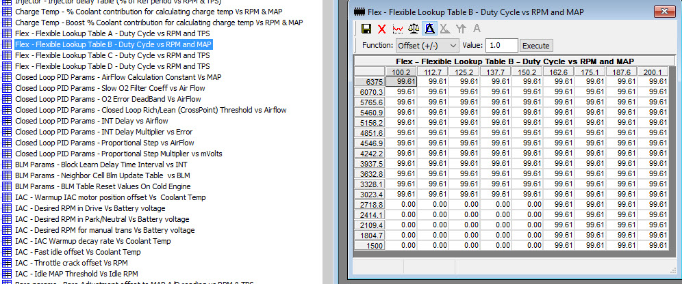

Holden202T wrote:post your bin and I can have a look....
also how do you have the relay wired up to the flex output ?
I use A2 as the connection (ground) to the relay. This was the EGR solenoid in the truck ... so easy to reuse the wiring. The relay is a stock volvo part specific for the boost control.
Mark.

Ok I've updated for flex b setup with RPM v's MAP axis and its whatever settings you already had in your tune in the flex b table.
this is how I set it.
So as you can see, the relay should turn on at 3023rpm and over 150kpa ... obviously you can change the table values to suit the map and rpm you want for no/off points.
I've also attached the modified bin file, and xdf file to suit.
Alex - $12P - Flex b.XDF
Alex 12P 2 Bar 1.0-flexb.bin
just for your knowledge, you need to load your cal/bin file in the flex table editor, then select the flex a/b/c/d etc then change all the settings to suit what you want, then from there you can
1. save the cal/bin file (this then needs to be uploaded to the computer to take effect)
2. modify the XDF which will give you the correct axis info and update the table name with what axis type (rpm/map/cts/tps etc)
make sure once you have done this you use that xdf to edit, and also make sure you use that bin file to load when you make changes, if you go back to an earlier bin file you will overite all the settings.
As i understand it the reason the flex table editor is in the ose flash tool and not part of tunerpro is that it needs a lot of special selections and coding to make it work which just isn't possible to do in tunerpro tables/flags etc. normally in tunerpro XDF the table settings are something that is hard coded and doersn't ever change once its been setup, so to allow all the axis changes needed in the flex tables that was the answer.
