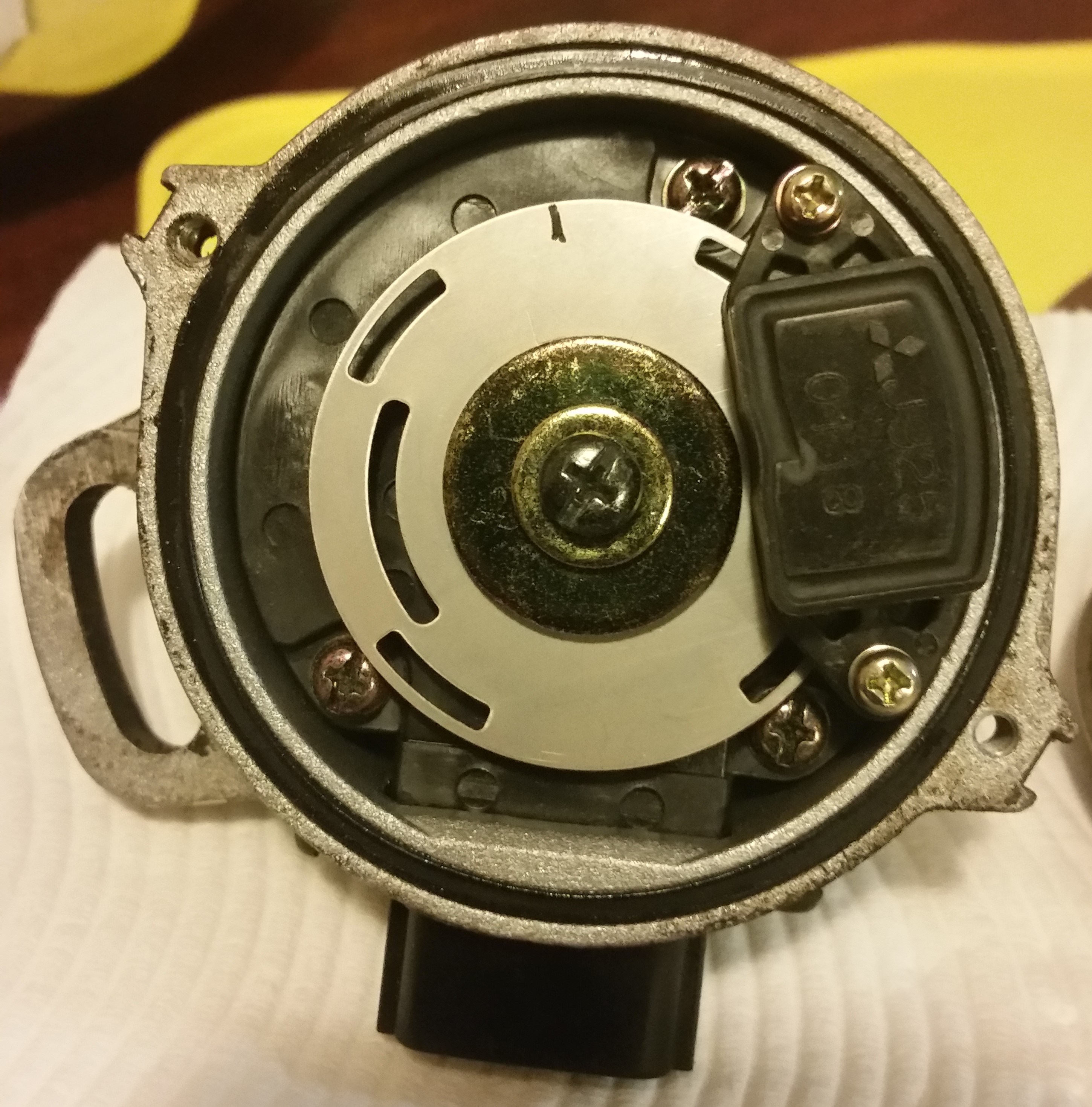

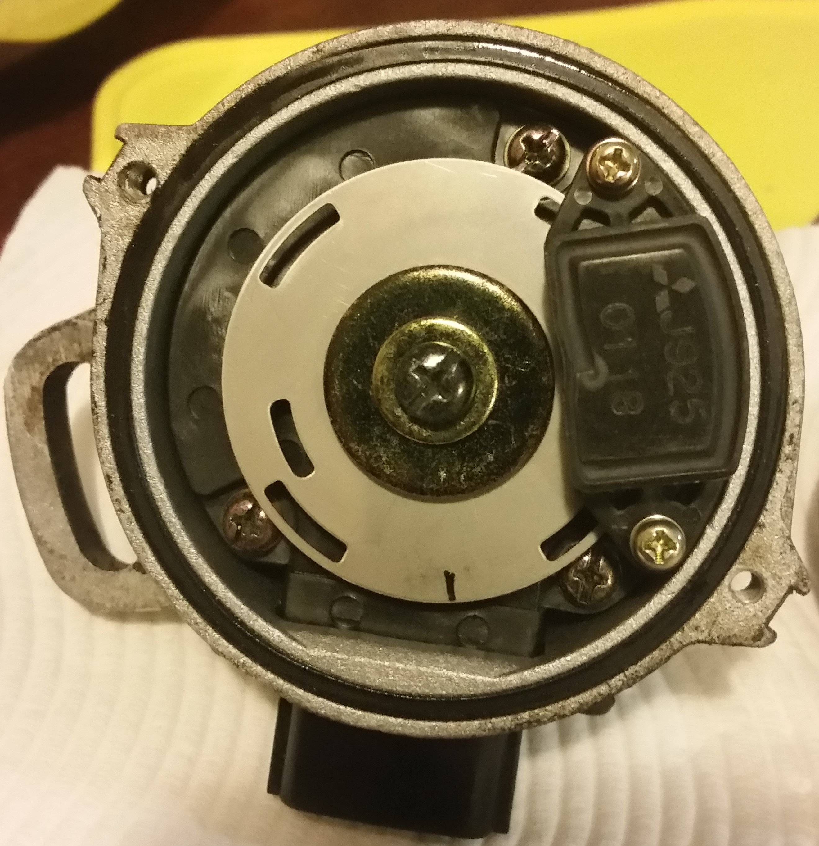

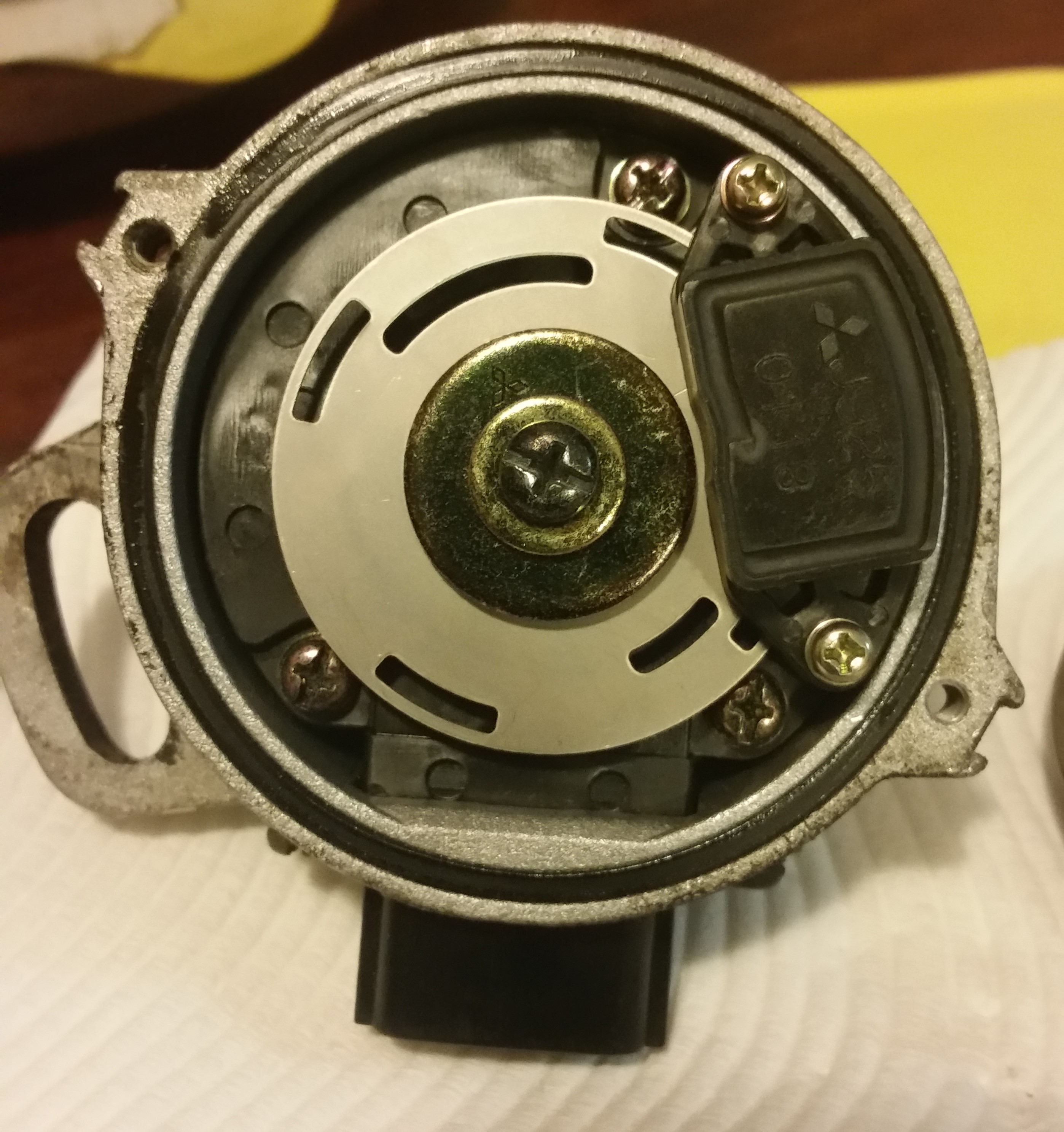

If you can get a pic of the trigger disc I can check if the existing pattern decoders in my module support it, if not can easily add a new one. The pattern could be a ref+sync like other Mazdas of that era which it already supports.
The hardware supports reluctor, optical and hall triggers which the CAS will be one of.

Thanks VL400.
Ill pull the cover off and get a pic of it for you asap.

VL400 wrote:If you can get a pic of the trigger disc I can check if the existing pattern decoders in my module support it, if not can easily add a new one. The pattern could be a ref+sync like other Mazdas of that era which it already supports.
In the last two pics I marked the disk so ou could see all the markings and know where they are in reference.
Its a mitsubishi part, # T1T49171 B61P 0205

Re: Datsun / Mazda /Nissan / Ford Frankenstein motor
The trigger pattern isnt in the current firmware but cant see any reason it cannot be added easily. Hardware will support it, just a simple firmware addition.
