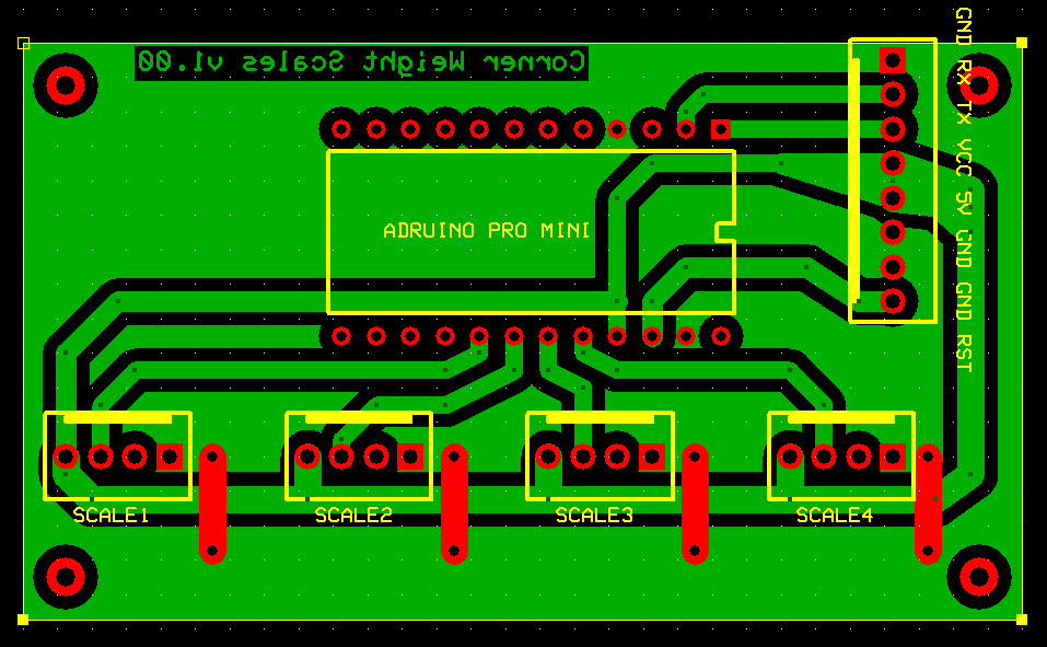

- Posts: 10328
Re: DIY Corner Weight Scales
So its been like a year since i touched this project, mainly because we have been renovating the computer and main bedroom, then we had a baby and well, we've finally got the rooms all done and the computer is no longer on the dining room table and all the boxes of electronics are accessible again
So i've made up a PCB, hopefully get it etched in the next few days and then assemble it and see if it links everything together as i am hoping!
the headers on the bottom are the 4 x connectors for the HX711 signal converters, and then on the side is a header for the nextion screen (top 4 pins) then external power input and then a pin for a reset button if i choose to add one.
