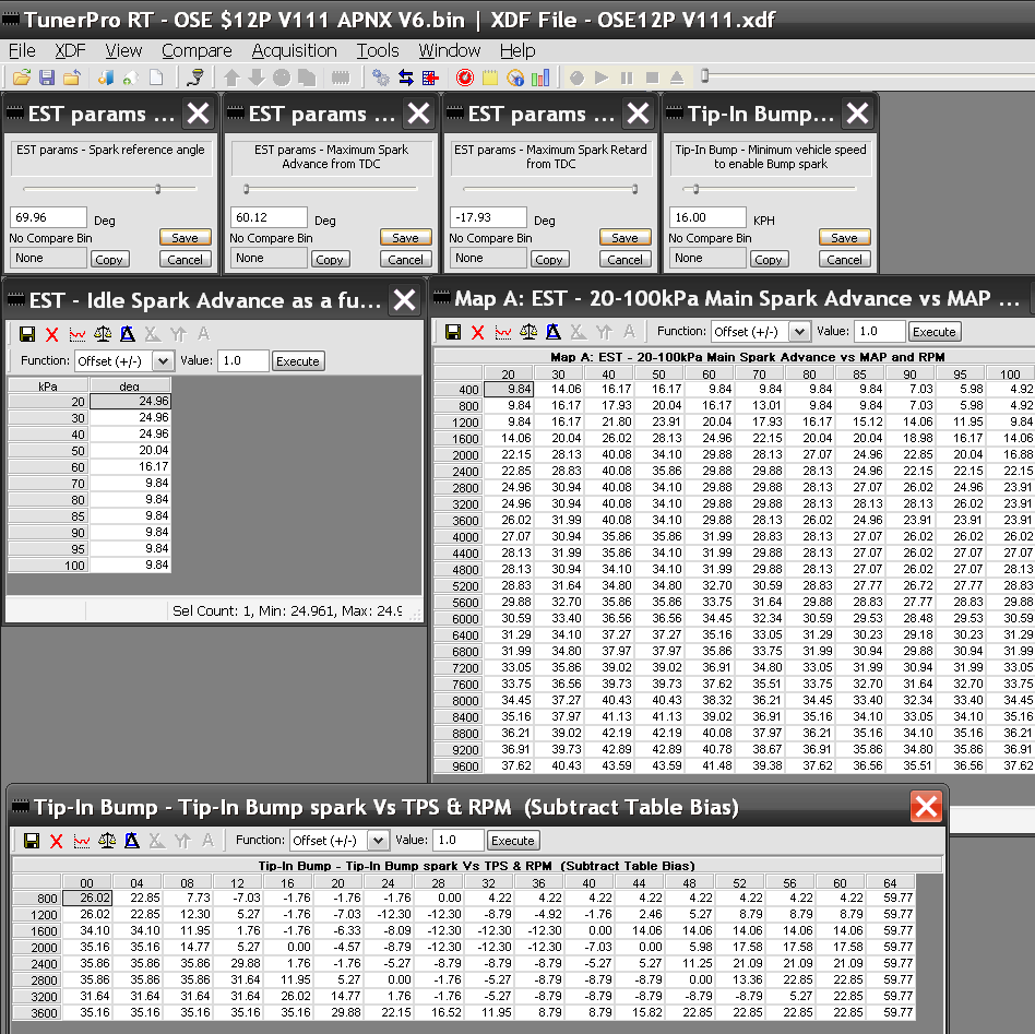

Maybe I'm missing something, but at what point are you determining it has a max of 10deg timing, just took a quick look at the alky bin vs the std 1.11 and looked ok to me.

I only had a quick look i'm sure the est temperature scaler was maxed out

Ah you mean this, wont that just make the tune act as though it hasn't fully warmed up yet.

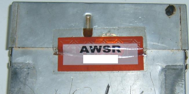

Another thing that has me wondering, the removable memcal cover on the end of the ecm has what I would say is a tamper proof sticker, half on the cover, half on the casing, leading me to think this is a controlled class, memcal has a 27c256 soldered in place to accomodate the larger 32kb program.
Wondering how he's going to get by when it's been opened.
And dam the thing's full of mud, even in the memcal.

Edit: Claimed ESC is Electronic spark control, but its not..... Thanks delcowizzid for the pickup.

Yeah I figured the esc meant electronic spark control, from tech days, didn't know the setting meant no spark control until the temp listed.
Having what looks to be a tamper proof sticker on the ecm leads me to think it's a contolled class though, 10deg wouldn't to an alky tune much good, so maybe there is some other factor altering the timing.

That sticker can be re applied at any meeting. Memcals can be modified so long as you can't adjust during the race. So no NVRAM with bank switching sort of deal and no data logging during a race.

Oh it was esc not est just had knock disabled then still controlling timing
