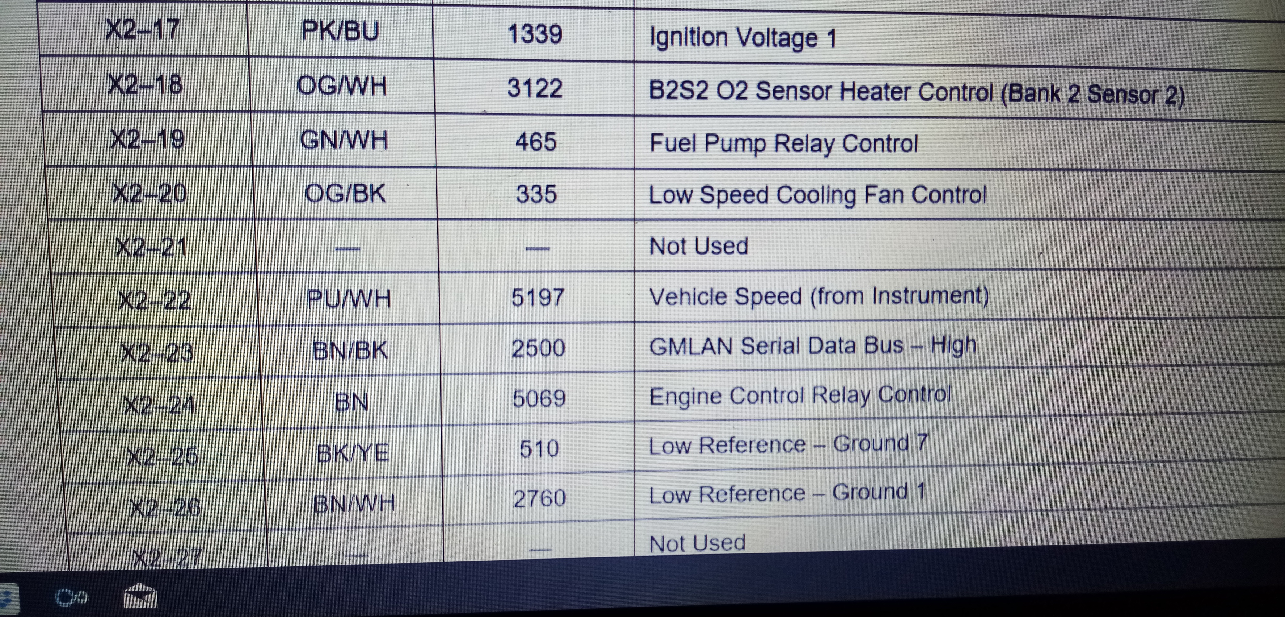

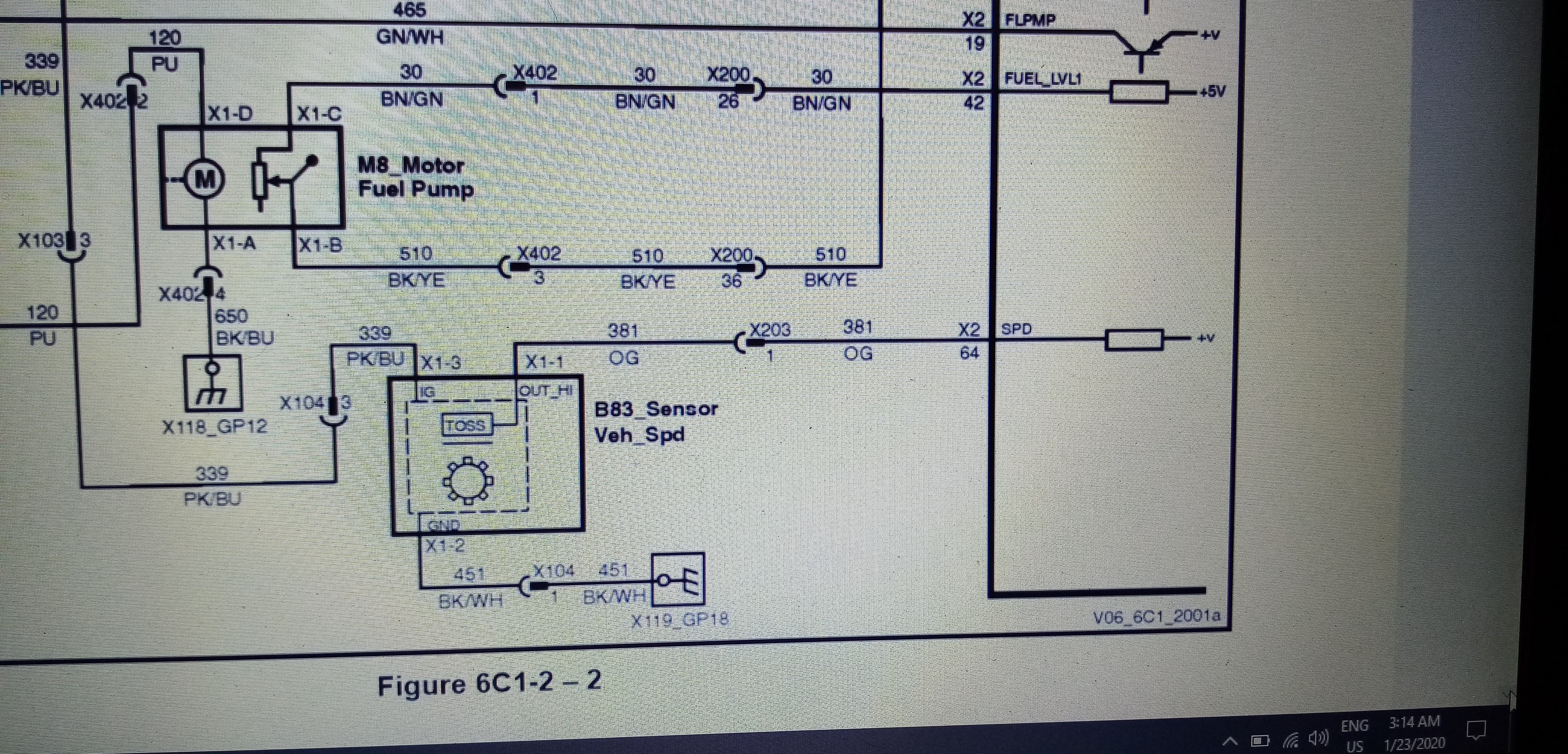

Here you go fired up the laptop at 3am lol
Pin 64 on x2 which is the ecu plug that goes to the body is vss signal in most likely via the big white loom plug behind the glove box where the auto loom and tcm plug into the dash loom after coming through the firewall. pin 22 on the same ecu plug is to the dash
- Posts: 5709
Re: VZ Ute speedo not working
Actually that shows it goes via plug x203 that may be the little plug that feeds the rear o2s behind the engine follow the orange and green coloured wire lol

so when the scan tool checks speedo pulse is it at the ECU or dash??delcowizzid wrote:Here you go fired up the laptop at 3am lol
So I should check pin 64 on the ecu back the the speed sensor to make sure it's connected? and check pin22 back to the dash?
also with pin 64 should i put my multimeter - to batt and + to pin 64, set meter to 12V it should pulse when the wheels turn in 1st gear right?
- Posts: 5709
