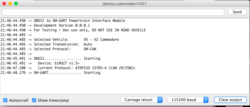

Soo, I've been a little productive today... got out and tested some PIDs just to see what responses I get and found that even just with testing LS1 and L98 PCMs the supported PIDs can be very different, so I will definitely need to do more research into what to do there...
on the plus side I managed to get my Arduino Mega talking to my knock off Elm 327 adapter, just need to actually write a function for it to work properly, quickly and strip off the echo.. but not sure how mch time I can put into this after the weekend.. have to get back to uni lol - the joys of re-skilling :thumbdown:
