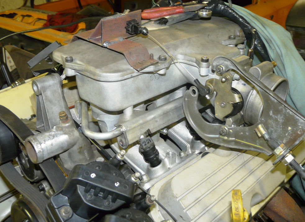

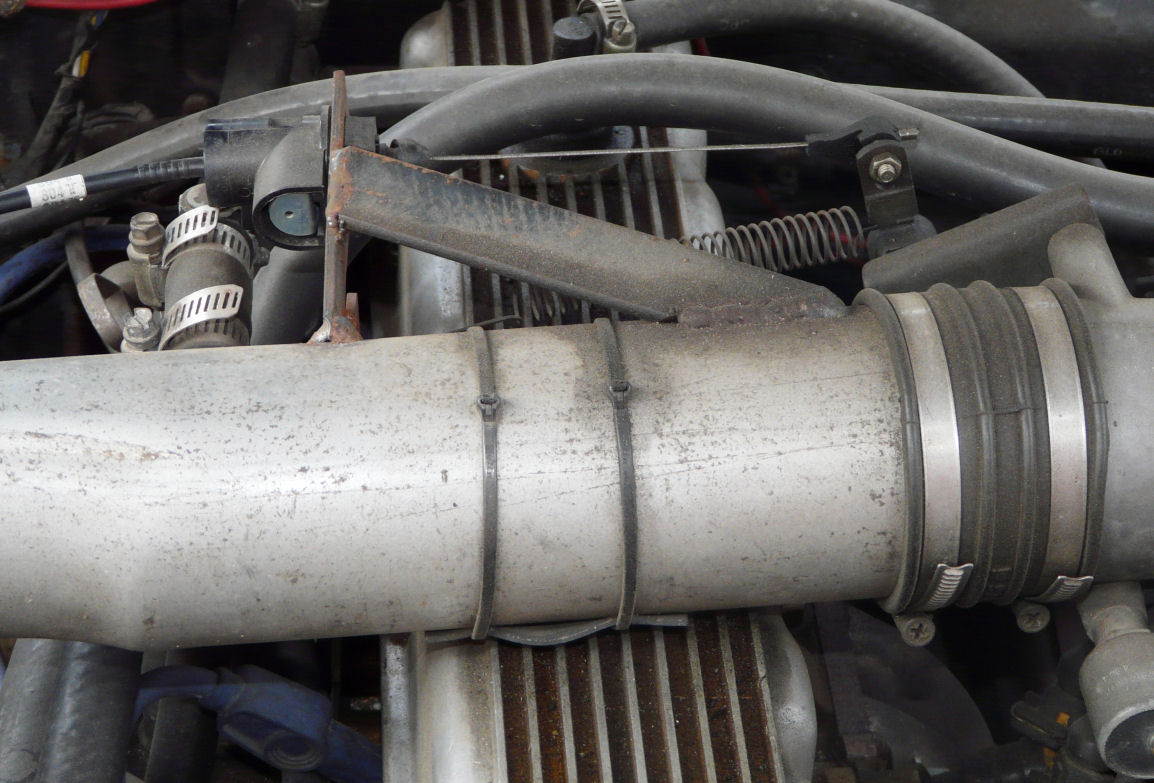

Is the tv cable clamped up further? I’m just looking at the amount of overhang out the end.
Re: 95 Hilux ecotec swapped - 808ecu
honestly the pic is still not that close up, but it does appear that the kick down cable is half hanging out the front the of the clip part.
if that is the case its probably never doing anything....
heres examples of T700 kick down cables i've done in a few conversions.
you want the cable to be torte at closed position, from there it pulls the cable out of the gearbox to increase line pressure with throttle increase!

Sorry been super slammed with work and haven't had a chance to play with it much this upcoming weekend ive been given off so plan is to get it all sorted as best i can on the weekend and no the cable isn't clamped further up it's just dangling and ziptied to the firewall so ill have to get a bracket sorted and try and work this all out, after taking a closer look with the sensors it appears for air temp im going to need to cut and trace back the wires so im also going to need to track down a VN style bosh plug and then track down someone who can flash a tune onto the memcal for me as at this stage i don't have a lot of spare coin laying around being so close to xmas so at this stage it's going to have to go onto the back burner but ill slowly chip away at things starting with that damn air temp sensor, so for placement does it matter What runner i put it in? or is it best to be in the plenum in the middle somewhere?
