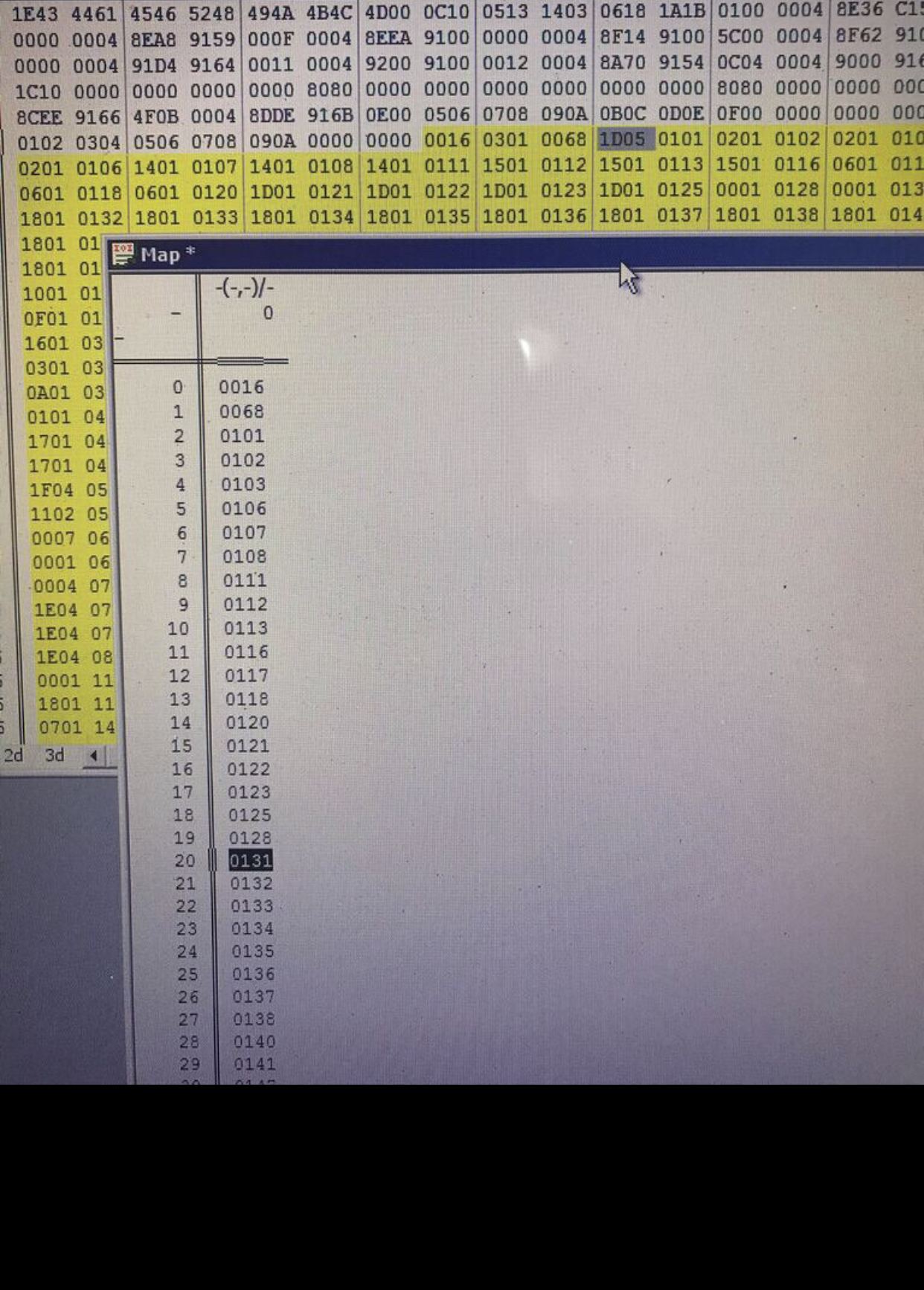

roughneck427
Posts: 58
Joined: Thu Feb 07, 2013 3:49 am
cars: 2002 Camaro
2008 Pontiac G8
Re: Reverse Engineering 12587603
Post by roughneck427 »
This is the 7603 os dtc lookup table axis. You have to view in 16 hi low hex and skip 2 bytes to populate the axis properly . If someone wants to add to IDA script for dtc look up table address is 87F74. Disregard I have the axis as the map it was easier for me to shift and move things toggle in hex and 2d mode
