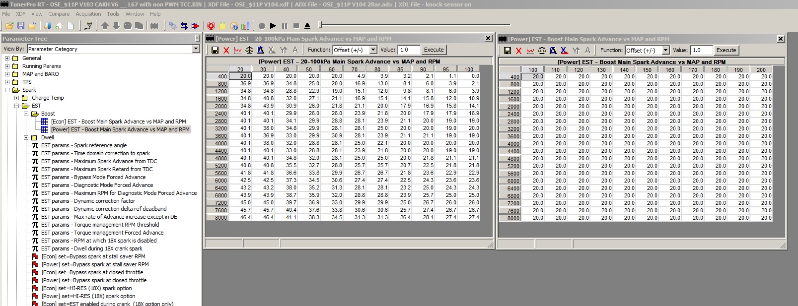

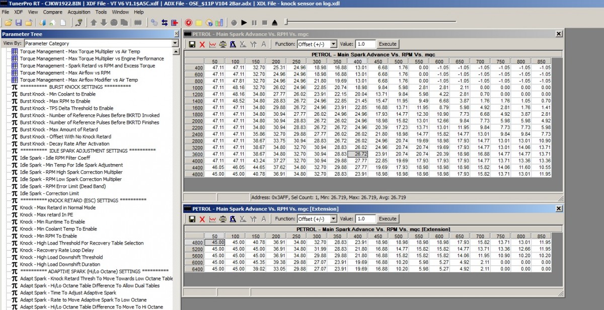

About to buy a aldl cable of here to go with my old school moates ostrich.
Fired up your custom tune vx l67 getrag and looks like the timing maps are a bit scattered.
Ve fuel table i can sort out with my wideband no worries
But the timing boost table should i use this vt super 6 table below?
I mean the 450 onwards table part of vt super 6 map looks like its boost onwards as its pulling timing slowly. Should i drop this into my 11p boost part of map to get me going ?
See pics below
sorry about all the questions

That appears to be the stock vr spark table in the 2nd pic.

It's just a file that was created to get to a start point, so adjust fuel & timing as needed & it won't directly relate to the standard L67 files as there created for MAF & not MAP.

20 degrees everywhere on boost won't be nice haha
