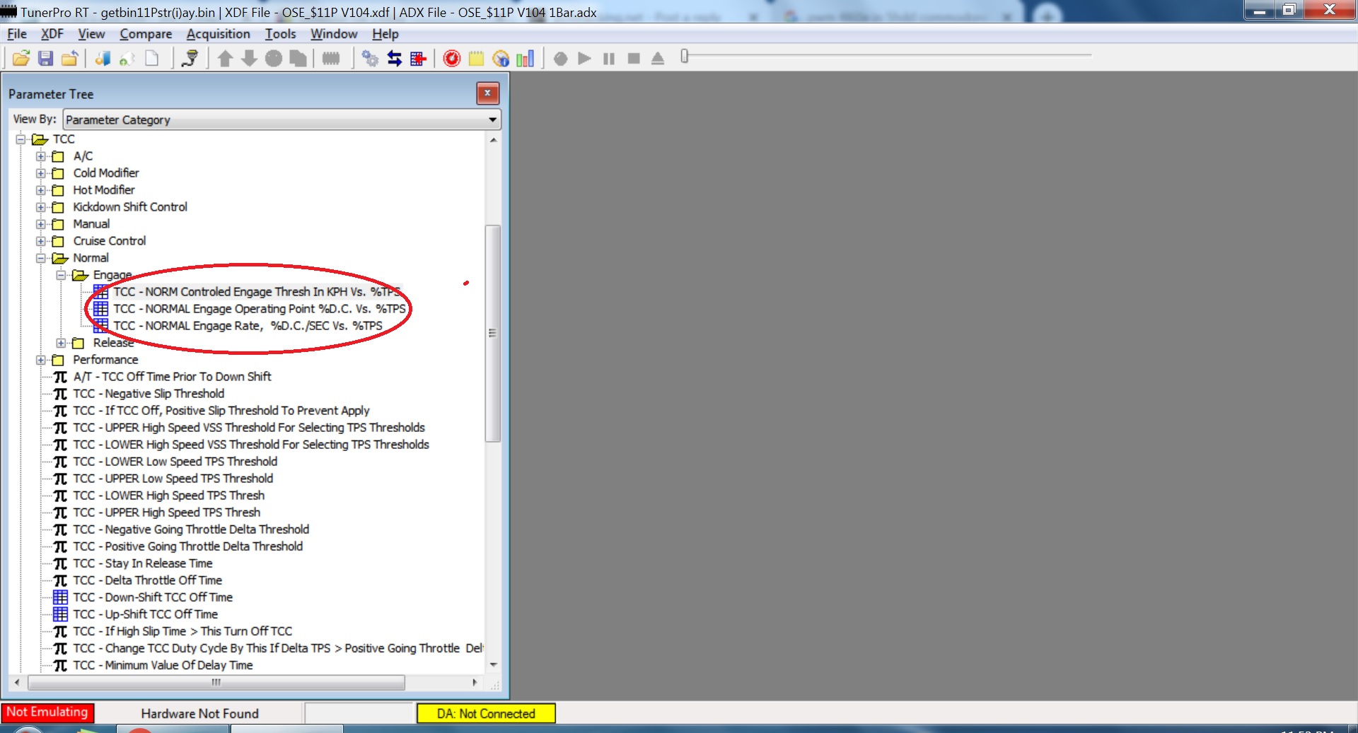

quipt4it thats what i think its called i read it somewere. Does something have to be changed on my tune to activate it so the tcc will work like standard ?

Can the pwm feature be turned on in 11p somewhere so my tcc works ?

If the trans matches the PCM it should work. What is the trans code (on the left top front of box).
If all correct, solenoid may be bad.

Post the engage tables

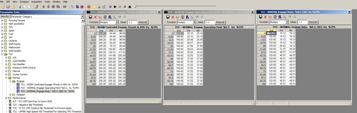

vp304
- Posts: 479
Re: 11p transmission 4l60e holding gears
See picture
im guessing the tcc-NORM controlled engage thresh in kph
For 4th gear up to say 31% tps should be lower like around 80kph ?
