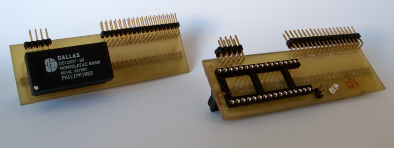

I actually had no idea how kalmaker was doing it until a member here sent me a picture of a SP3 ECM, I could never afford the $$ they were asking and driving a stock 5L I had no real use for the extra features they added anyway. The first prototype of the comms board was back in about 2001 when i had a check engine light. No one could tell me anything about it - but were happy to charge me - so started to investigate things myself. I built a wideband that used a HC11 for tafe and after realising that the ECU in the car was also a HC11 added a max232 hot glued to the PCB! I never took a picture of this, wish i di though.
The NVRAM board was an extension of montecarslows mode 4 ALDL idea, so I have him to thank for the idea of adding an NVRAM! The first prototype was in 2005 and used a DS1230Y, but then after aconversion to a VR V6 and 4l60E in my brothers VK revised the board and added a DS1245Y for dual maps and support of 64K bins. Here are the protypes that were used for nearly 3 years in various vehicles...
So really thanks to a missing VSS on my VL and montecarslow we are where we are today!
