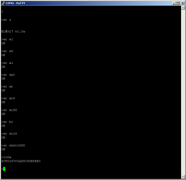

Re: Using capture vpw from pcm hammer tools. Cable setup hel
So you're actually finally trying by pasting the commands and it works.
You can only do one command at a time ... It's a command and response interface.
Once you get your tool setup correctly with the correct AT commands it'll come out much better.
When you paste ATZ into PuTTY do you also include the Carriage Return or do you hit enter after you paste ??
You must also include the CR so it takes action on the paste, NO ENTER KEY USED.
I would be using VPWDecoder or simply PuTTY to learn the operation of the ELM327.
Gampy wrote:It's a command and response interface.
The following is what a typical ELM327 session looks like, I would completely forget about CaptureSerial ...Gampy wrote:each command should return at the very minimum a response of OK or ?

I write something up real quick that might do the trick, at least give you something to work off of.. It's kind of a copy and paste from when I was working with elm's a few years ago. link below is to the source if you want to see it and change it as needed to suit you. look in the bin folder if you just want to try the exe file.. I used visual studio to create it.
IIRC ELM327 v1.5 is a known bad clone, there never was a real v1.5 produced because of this clone that got released before a real release of that version.
However, it still does work to some degree ...
No way to script it in PuTTY.
The best way to copy a single command for pasting is to create a text file (notepad), type each command on it's own line, then place your cursor at the beginning of the line for the command you want, hold the shift key down, hit the down arrow key one time, then hit Control-C to copy it to the clipboard.
That technique includes the CR.
