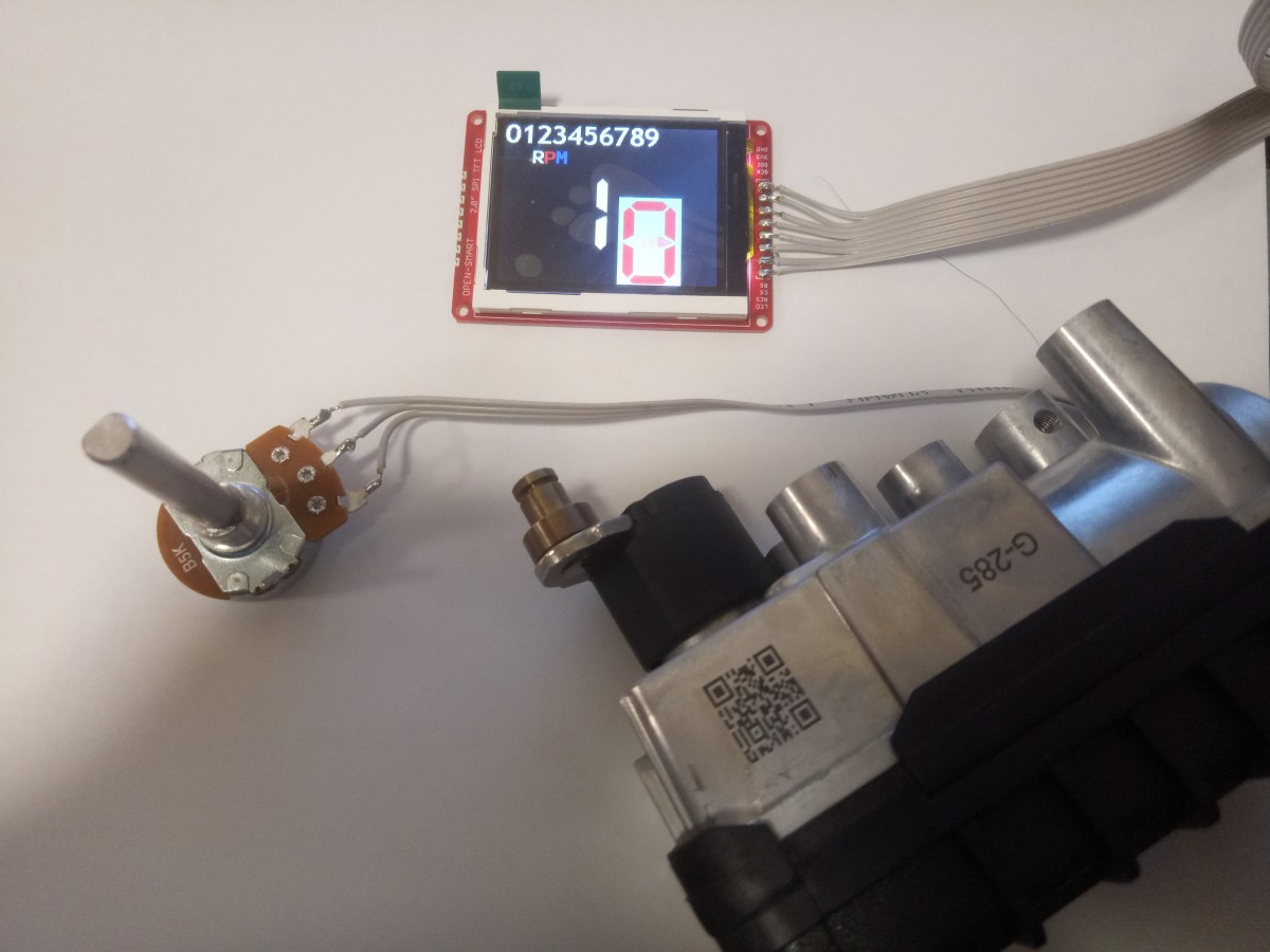

LSD CV shaft's ordered! Due next week. In the meantime...
The VNT Electronic Actuator arrived! This is a type G-285 which from what I have learnt decides its bolt pattern, range of rotation and interface protocol.
The G-285 will accept either CANbus or PWM control. I'm not sure the CAN address though after some testing I've found its PWM frequency to be pretty wide. I tested as low as 40hz and as high as 10,000hz. The actuator responds equally well. I've gone with 500hz because the timer hardware in my MCU was already set up in this configuration. PWM range is linear between 0 and about 95% after which it will return back to 0% as a kind of fault condition (open signal wire). This is a Chinese version, not an original Hella brand. I've heard they're more particular on PWM frequency.
The signalling into the actuator is 0-12v. It has a weak pull-up so a simple FET or NPN can pull it down to 0v using a MCU's logic output.
The LCD is replacing the temp indicator in the dash. It'll show coolant temp when manifold is under vacuum and turn to a boost gauge when positive pressure is sensed. It'll also flag any problems like high temp, overboost, spark cut etc
The VNT controller code itself decides VNT nozzle position using Lookup tables referencing TPS, MAP, RPM. This should keep VE as high as possible at all times and manage boost safely and accurately.
I've got a VNT 2.2L turbo out of a BT50/Transit on its way that will be used in this build. I'll post pics when it arrives. It looks big enough to keep boost under control up around 6500rpm and hopefully responsive enough to make good power from around 2k. That's the goal anyway
