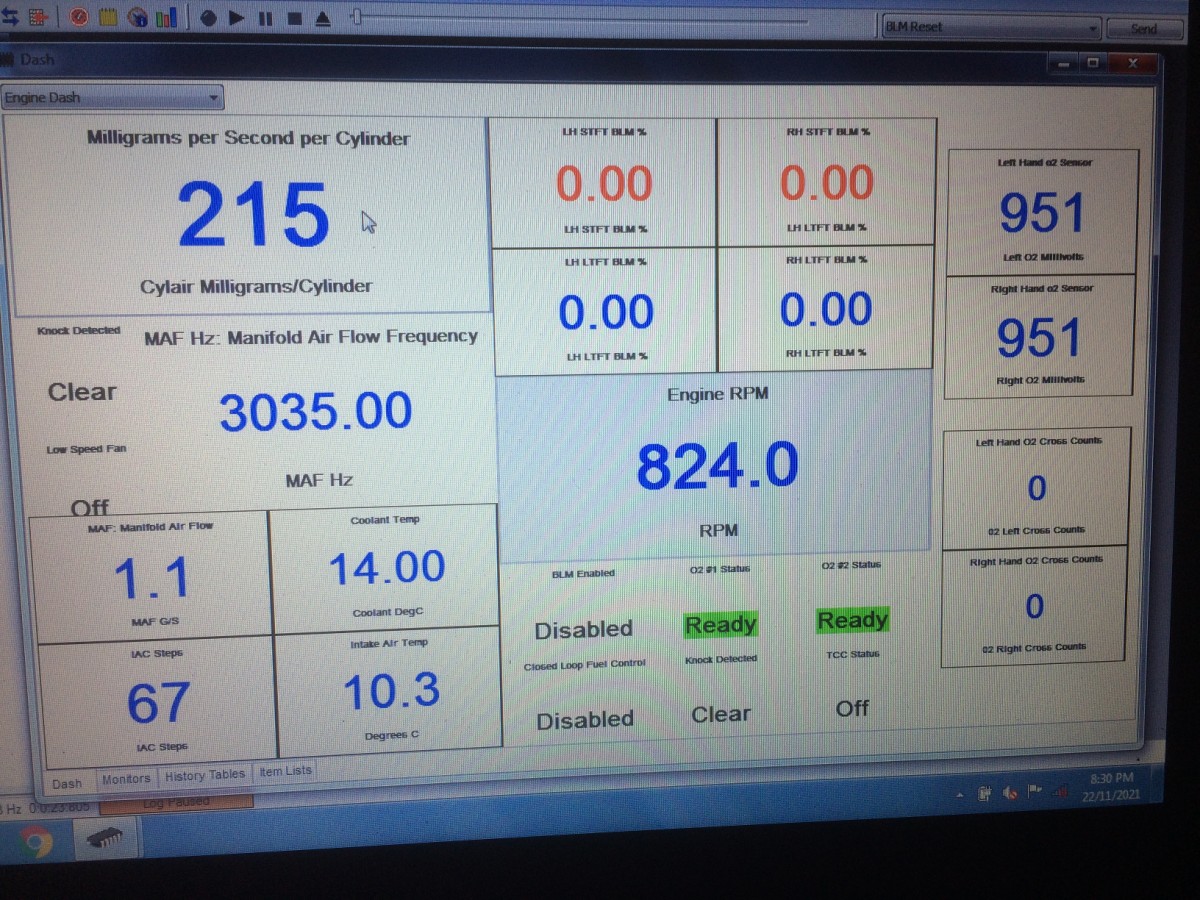

Good evening gentlemen. I have uploaded a pic of tunerpro screen from weekend log

On that log when I made it to 2000 rpm my frequency was 5400 and my MAF G/S was only 5.1. After reading Gareths post earlier today I called the place that reconditioned the MAF sensor and asked what they think the idle frequency should be and the said 2470, so basiclly the same as what Gareth said. I spoke to a commodore enthusiast that works there and he too uses tunerpro and recommends it. We covered all the changes I have made to the car and he thought that should have fixed the problem with the over fueling. He too suggested swapping the PCM over to the other one I have.

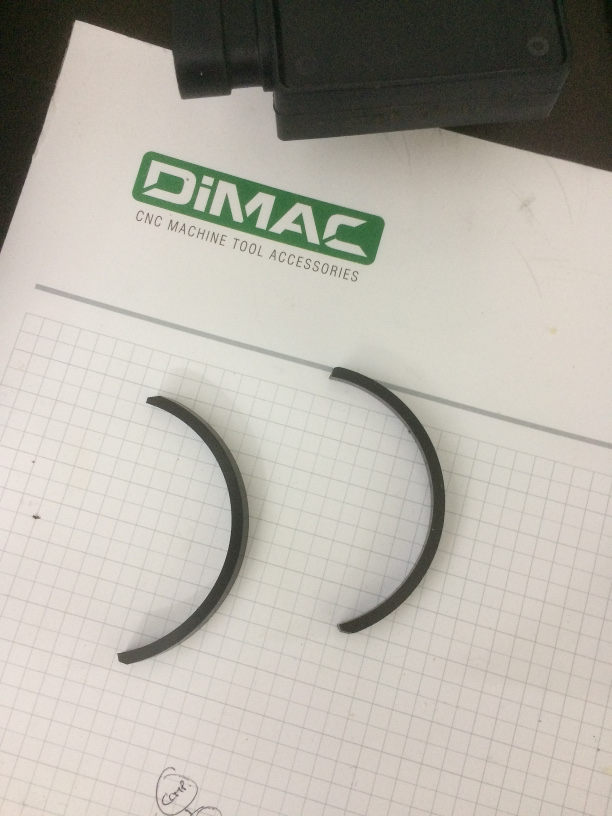

So after finding out what the MAF frequency should be at idle and 2000 rpm, and mine being quite abit higher than that I was thinking of what to do next. I wanted a way to change the frequency for testing purposes with hacking things up. My thought was to shrink the I.D. of the Maf there by allowing less air in. So I turned a piece of acetal to fit inside of the MAF cut it in half and trim the ends to make a tight fit and decrease the diameter by 8mm. Installed them on the back side of the MAF and started the engine. Instead of the frequency dropping lower, it raised up to 3300 at idle. Then it dawned on me what I actually did was raise the air speed, effectively raising the frequency. Drats!
- Choke
- IMG_0049.JPG (161.61 KiB) Viewed 2132 times

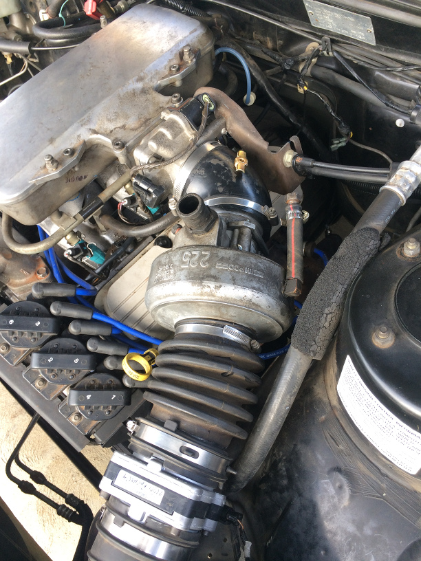

So that led to the next conclusion, if choking the air increases the air speed thru the MAF than increasing the air volume should slow it down. I think I mentioned earlier that the car was duel fuel when I got it and the gas wasn't working. To get the roadworthy the mechanic told me to pull it all out, so that's what I did. So I thought if I reinstall it I can do what ever I need to so I can add an adjustable vacuum leak. The rubber elbow leading into the TB was about 6mm thick so I drilled a hole in it and installed a petcock. Now I can adjust the vacuum leak to get the frequency down to where it needs to be. At idle I have it at approx. 2450 so we'll see how it runs tomorrow on the way to work. This is only a temporary set up to see if I lower the frequency will the over fuelling problem subside. All of this has made wonder if the car would have been retuned when the gas was installed. Also I noticed in tunerpro there were tables mentioning the MAF frequency, so is fuelling adjustable to the MAF frequency?
- IMG_0050.JPG (295.55 KiB) Viewed 2131 times
