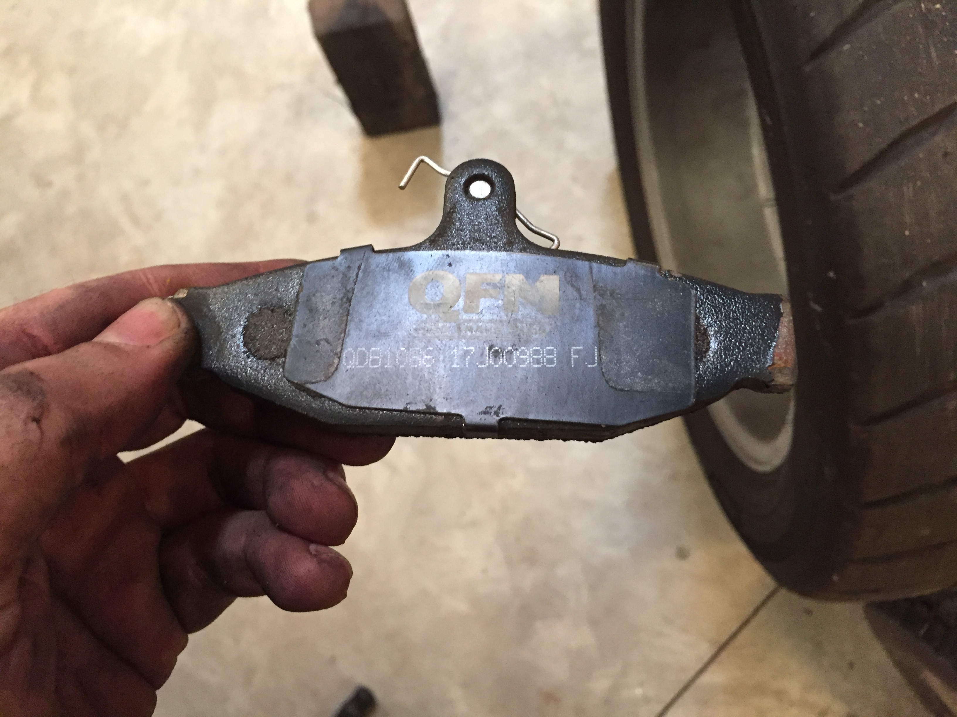

Those shims are supposed to reduce/eliminate squeal but I'm afraid some engineers think all cars need them.
- Posts: 8114
Re: Brake pads.
Those shims were never an issue when they were just a steel free floating shim but once they started rubberizing them and gluing them these issues showed up.
I thought I was crazy having worse brakes on the red VP vs the VR but now I know why.
- Posts: 1950
- cars: V8 VR Commodore BT1
Re: Brake pads.
There is a silicon based product that you smear on the pad contact patches to help reduce noises. I'm surprised that it caused a problem.
- Posts: 8114
Re: Brake pads.
I asked my mechanic about this and he confirms the same issue.
- Posts: 3676
- cars: VH, VN, VS, VX
Re: Brake pads.
Interesting. I'm sure the pads in the Calais have some sort of rubber backing on the shims. Might have to scrape it off and see what happens?
- Posts: 8114
Re: Brake pads.
I think it's less of an issue on bigger/better modern brakes as they often have very firm pedals with great braking effort for minimal input so it won't be so noticeable and also caliper flex is next to nothing on modern calipers.
With the old girls like VN etc.. there is more pedal travel out of the box, small pads for the force applied and flexible calipers, it all exacerbates the issue.

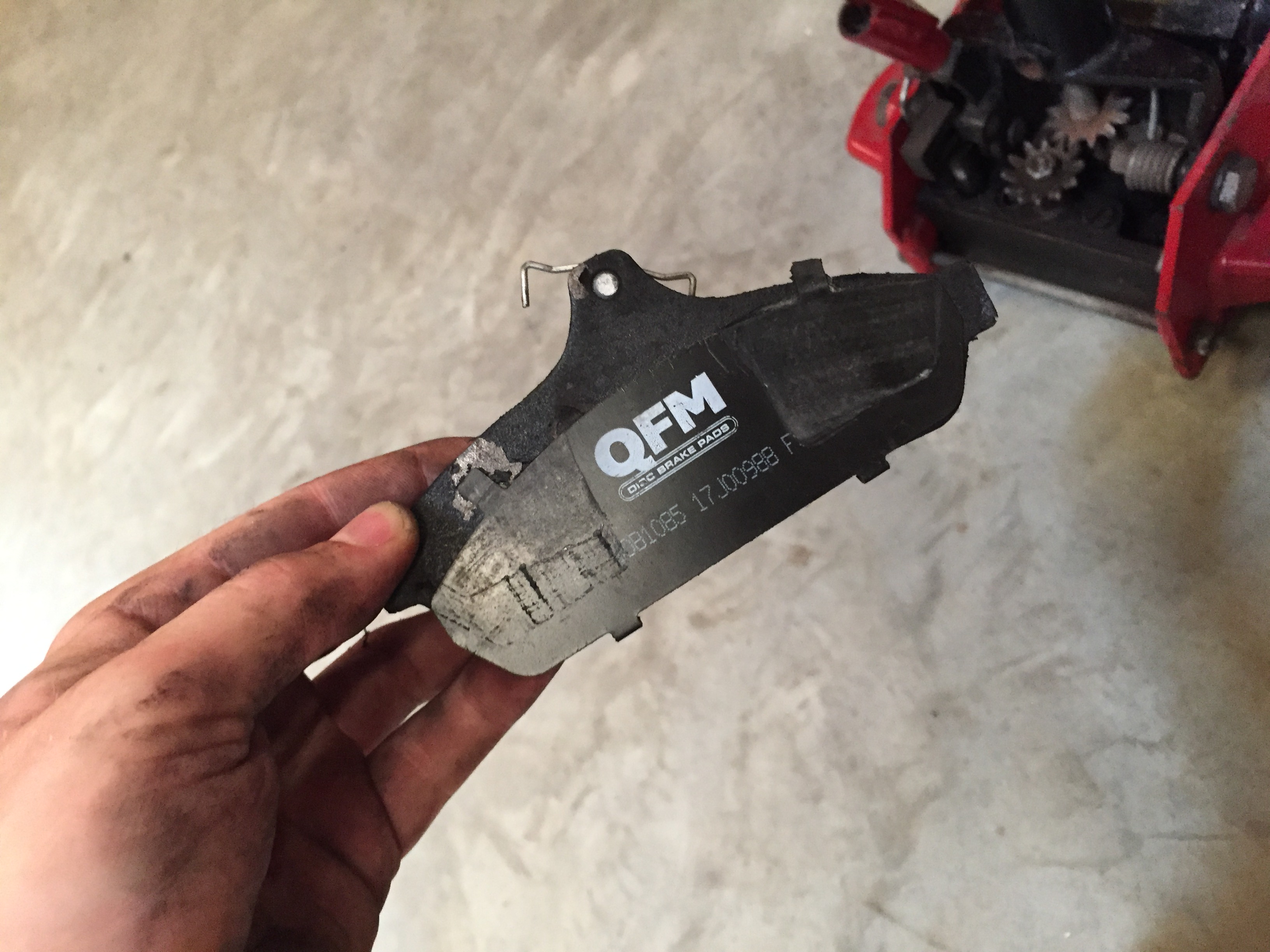

- Posts: 8114
Re: Brake pads.
Got around to sorting the red car out, these shims moved even more than the other car.
You can see how much these shims can squish by the bending and depression from the piston.
Pedal feel is quite a lot better now, but won't be able to road test the car for a while as my brother has filled in the roller door area with junk and a indoor spa.

Im thinking you must ahve lots a movement in the caliper to allow the shim to moove that much. Maybe it's time to look a bit closer at the whole assembly. I know you did a tight arse with the rotors which really are quiet cheap.
- Posts: 8114
Re: Brake pads.
The red car was a full restoration. The movement (flex) is normal for these calipers. I never had this issue before becasue pads for early commodores never had these shims until recent years.
The flex is why it's normal for VB-VS brakes to take 1000-2000km to wear in as they need to wear as a taper to compensate for the flex in the caliper.
- Posts: 1950
Re: Brake pads.
