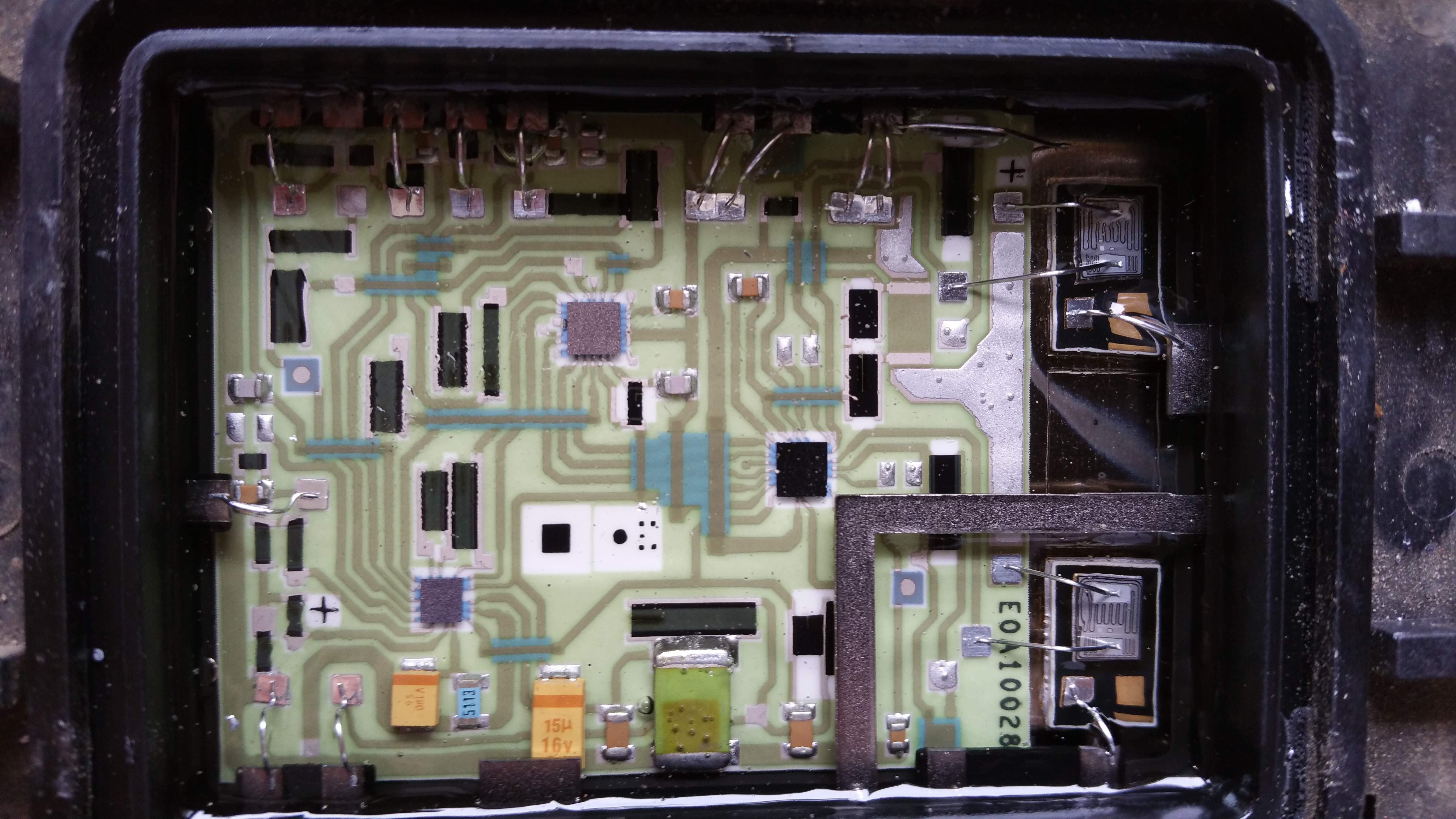

And about DIS module, almost always its broken power transistor(mosfet?) the biggest one at the end of module, but it is unrepairable because of epoxy resin which all modules was filled.
Edit, there was probably two manuractures of it. I found one that was filled just by sticky gel.
And where can i find what exactly eprom contains? Just generally like fuel map, processor code, malf-s, what else?
