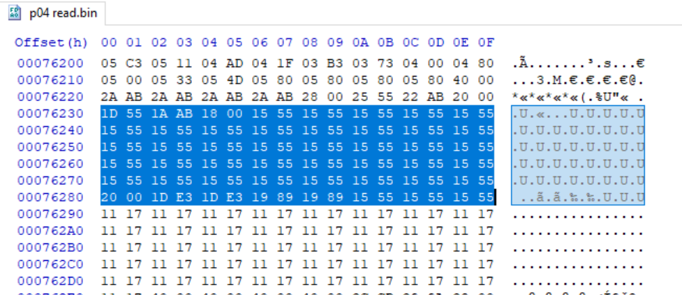

This is the bin image from my problem PCM, and the bytes that seem to crash the kernel.
55 15 is 0101 0101 0001 0101 so I think there is something to that pattern, repeated. The 11 17 could be part of it too, since its 0001 0001 0001 0111.

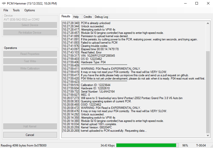

I loaded this bin on to my p04, and read it back with pcmhammer with 4k packets with the current kernel in the develop branch and no issues at all. Very interesting. Maybe a very obscure data issue with my original bin only?! At least I think this confirms not a security issue since its the same hardware, same kernel.
note the failure in the screen shot was because I had not rebooted the pcm initially after its first flash writing. also this OS is not in the pcmhammer source, I just added it in to my local copy for this test only. We need to get a more complete list of P04 OSIDs and add it to the tool.
