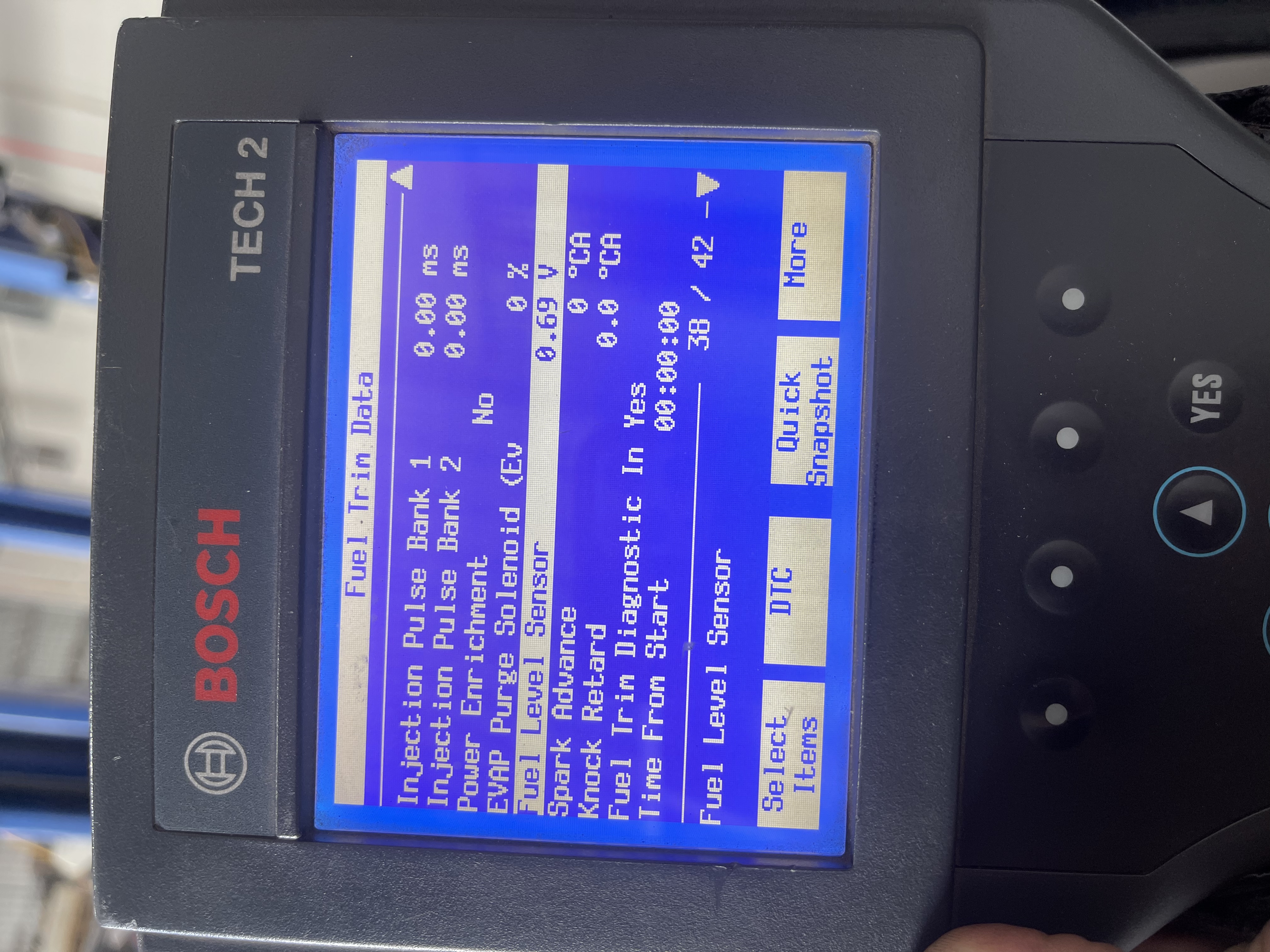

What does the PCM show in live data for the fuel ohms when doing the tests?Gareth wrote:The wiring between the tank and PCM is fine also, no shorts to earth or each other.

That’s with no sender plugged in
Re: VZ/WL Fuel guage woes
With the sender plugged in and set to empty it’s 0.69v, with the sender at full it’s 2.39v
Soooo, based on that it isn’t the PCM is ok. So that leaves PIM and BCM…

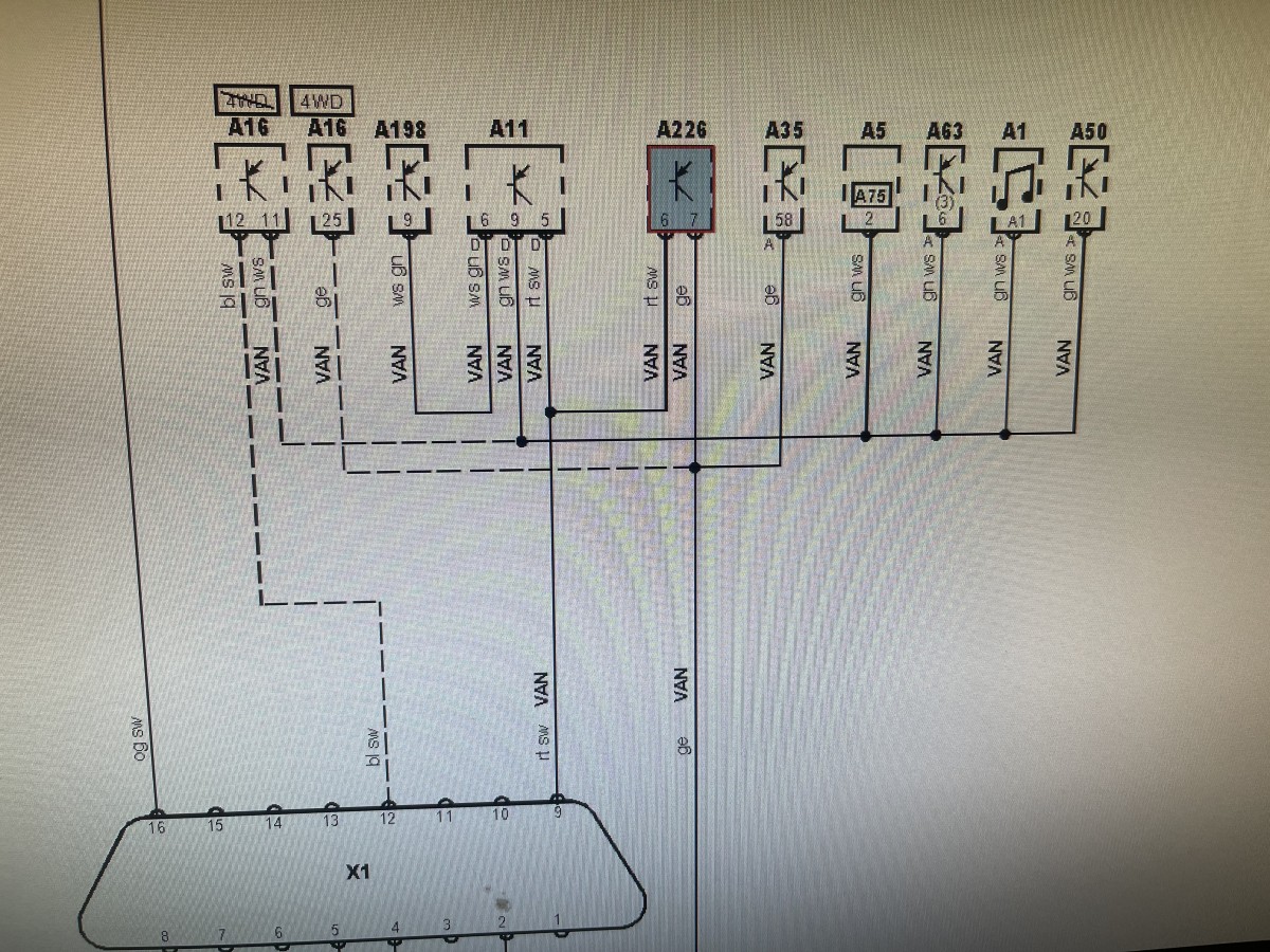

[attachment=0]EA3FE767-6ED1-4BC7-BB5B-CED4617BA607.jpeg[/attachment]
A35=PCM, A226=PIM, A11=BCM, A5=IPC
So there is no live data with tech2 for fuel level in either PIM or BCM so that fucks that.

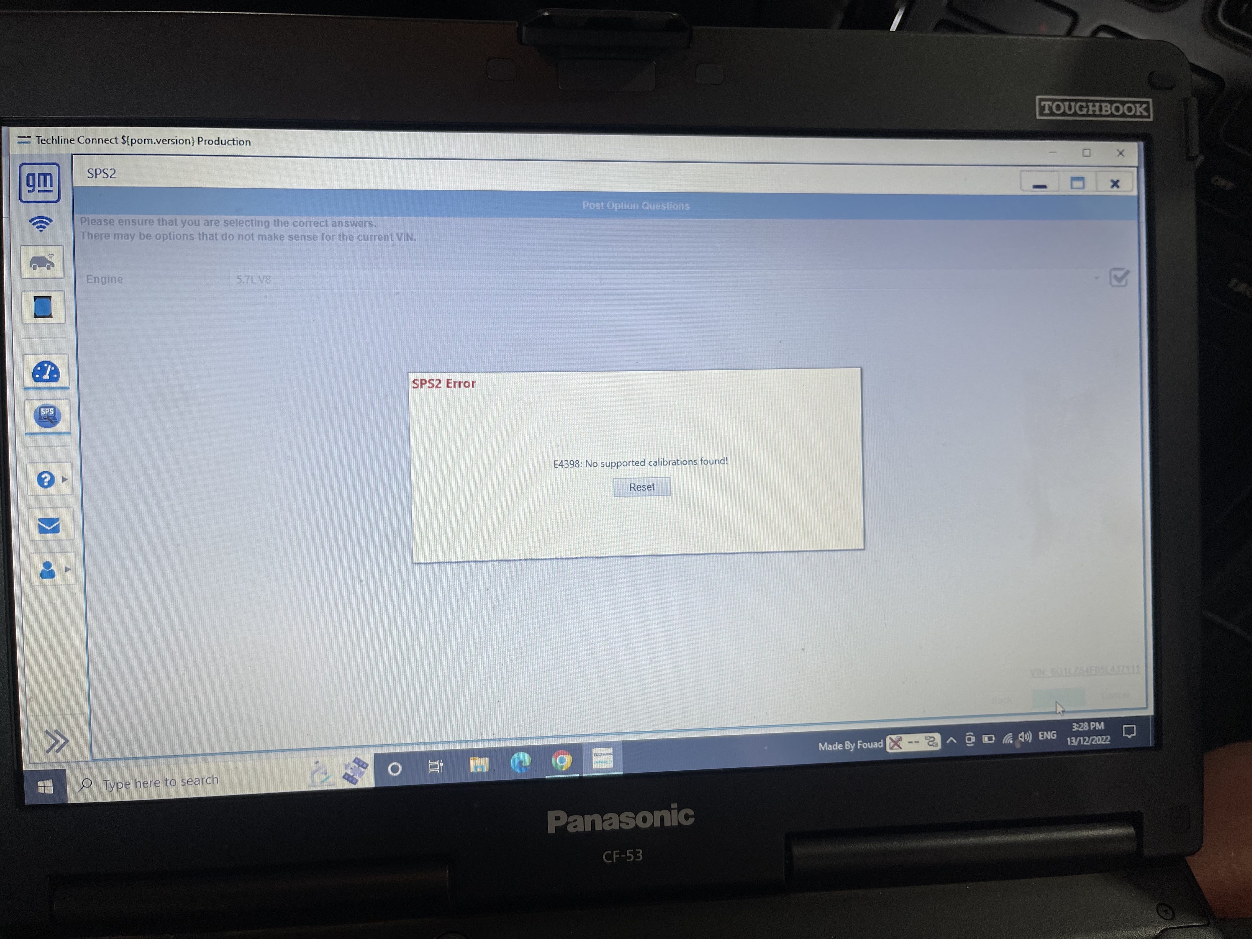

There is one of the issues I can't resolve - The PCM I cannot update as SPS says no...Tazzi wrote:Honestly sounds like making sure the ECM and IPC are up to date with the latest calibrations would be the starting point, since the newest updates addressed a fuel gauge related issue.
