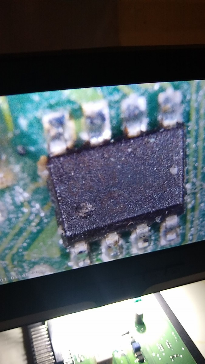

I had one but some idiot stole it. I think i'm just going to stick with this se bcm, seems to work fine with vats turned off. I'm a bit hesitant to try this script purposed because things are working alright besides tech2win not being able to see the bcm/resets. I really don't want to throw anymore money into this car since i've already spent close to a grand just to get the grand am working :D Trying to find a bcm for this car without corrosion is damn near impossible. Gm/pontiac knew what they were doing when they designed the car to soak the bcm when it rained. I just don't know what to do, i've bought chipquick, i've taken the chip off the gt one and soldered it back to see if i could do it. The hot air pen i was using is butane and the lettering is no longer visible on the chip so i don't know if it's any good now. I just don't want to screw anything up and spend more money.
Posts: 9002
Re: Need someone to program a 8pin eeprom desolder/solder
DethRattles wrote:The hot air pen i was using is butane and the lettering is no longer visible on the chip so i don't know if it's any good now.
You can damage them with a lot less heat than that. There is a very strong chance its dead. If your happy with things, its probably a good place to stop.

You use a torch on it and you'll likely destroy it, when people say use hot air they mean thermally controlled electric hot air not hot air from a torch.
Yes, someone good with a torch can do it, but they ruin many chips in the learning process.

It's not all that cooked as you can see..pretty sure it's still viable. The 3in1 harbor freight soldering iron works pretty good but as I said the lettering is hardly visible. Soldered it back on a little crooked but that eeprom is tiny af.
