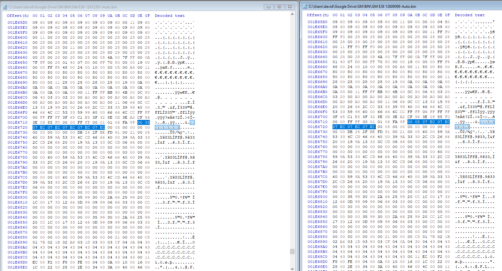

so found a small interesting difference/offset between os 12609099 & 12612381.
Since i already had some tables mapped out in 12612381 I went looking for the same data in 099. Looks like everything is identical & there is an offset difference.
Now this might change as the newer OS evolved, but thought it was interesting at least. So if someone was smart enough & had a full file definition it could be easy to map out various operating systems.
Re: Current Status on E38, E67, etc.. Hacking Toys
it's very common to see similar data at different addresses with gm. it can be very helpful
