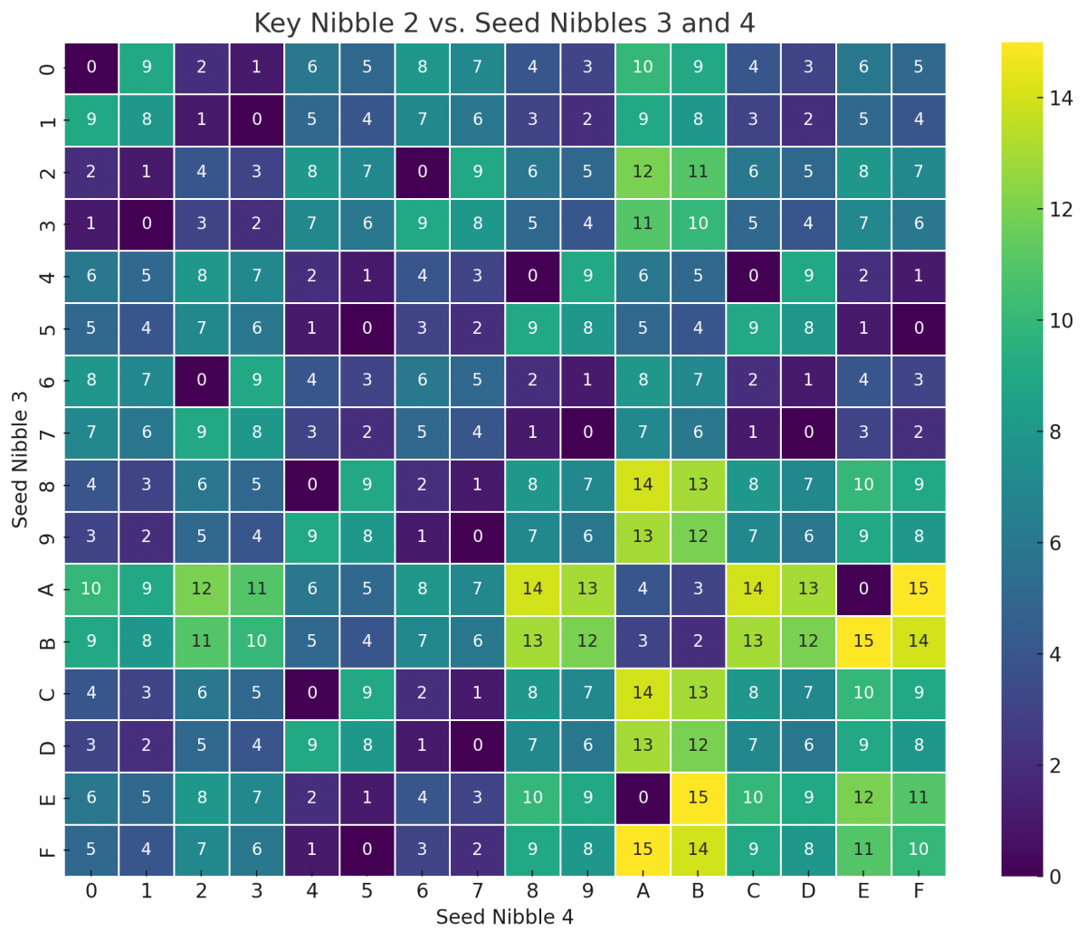

This here is getting pretty close, at least for the first and last key nibble:
29 mismatches found from 199 pairs checked against:
Key Nibble 1:
Out by +4: 8 time(s)
Out by +12: 7 time(s)
Key Nibble 4:
Out by +4: 14 time(s)
Out by +12: 12 time(s)
So the nibbles sometimes end up either 4 more or 4 less than they should be (they wrap around at 16).
Maybe a missing XOR 0x4 ?
Once I work that out I'll move on to looking at the middle nibbles. And then get a script running to pull some random pairs from forscan overnight, and then verify they all match. Probably find some edge cases, then rinse and repeat.
What I'll end up with will probably be much less elegant than how its really done, but if it works it works.
calc(seed1, seed2, seed3, seed4) {
sn1 = (seed1 >> 4) & 0xF;
sn2 = seed1 & 0xF;
sn3 = (seed2 >> 4) & 0xF;
sn4 = seed2 & 0xF;
sn5 = (seed3 >> 4) & 0xF;
sn6 = seed3 & 0xF;
sn7 = (seed4 >> 4) & 0xF;
sn8 = seed4 & 0xF;
kn1 = sn2 ^ ((sn2 & 0x8) ? 0x1 : 0x5);
if( (sn2 & 0x1) && ((sn3 ^ 0xA) < 2) && ((sn4 ^ 0xA) < 2) ) {
kn1 = (kn1 + 1) & 0xF;
// kn2 yet to be calculated
// kn3 yet to be calculated
kn4 = sn7 ^ ((sn7 & 0x8) ? 0x1 : 0x5);
key1 = (kn1 << 4) | kn2;
key2 = (kn3 << 4) | kn4;
}29 mismatches found from 199 pairs checked against:
Key Nibble 1:
Key Nibble 4:

Haven't found the inner nibble calculation yet.
I've been running a python script that generates regular expressions and runs them on the full set of seed/keys from "00 00 00 00" to "00 FF 00 00".
It was taking hours per pass until chatGPT helped me setup the script to run multicore - now takes less than 40 minutes.
Matches 94 / 256 sets (36% success):
( (SN3 ^ 0xA) & (SN4 | 0x5) ) ^ SN4
or
( (SN3 | 0x5) & (SN4 ^ 0xA) ) ^ SN3
Matches 75/256 (29% success) :
"SN3 ^ 0xA ^ SN4"
I suspect I will have to break the sets up into separate sets that work / don't work with a formula, and try see if there's any way to identify them for conditional logic / branching.
EG. I already know that if both LSB/MSB's of SN3 and SN4 are clear, the formula "SN3 ^ 0xA ^ SN4" fails every time.
It's also possible I may be able to find a formula that get the top 3 bits right, and I can change the LSB using the simple SN3 ^ SN4 expression (assuming it holds true over larger data sets, which it has so far)
Assuming I'm right that the KN2 and KN3 are mirrors of each other in how they are calculated, and my calculations for the rest hold true, I'm really only searching for 4 bits off data. It wouldn't be unfeasible to implement the whole thing with a 256 byte lookup table. If the LSB really is just SN3 ^ SN4, its only 3 bits and needs a 64 byte lookup table. Since we're only looking up nibbles, store 2 in each byte and its now a 32 byte lookup table. If I run into a wall I might even implement that and then start testing with randomly generated seeds / keys.
Here's a heatmap from chatGPT showing the key nibble 2 results from 00 00 00 00 to 00 FF 00 00:

- Posts: 10013
Re: BA Falcon BEM EEPROM via CAN
I reckon you'll find there is another salt in there, like an and or xor with a 3F or some other value.
