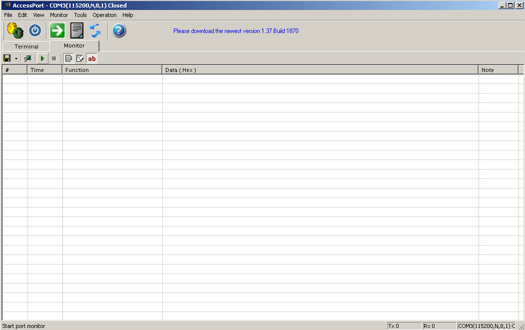

Set it up something like this, and then start monitoring. I havn't used it for a while and don't have an interface on this pc, but from memory the order of when you start monitoring and start using the port matters. If it doesn't work monitoring before starting the other app, do it the other way around. You might have to try it a couple of ways. Its possible the latest FTDI drivers don't work on XP. It'd be general windows trouble shooting to see if the interface is working, and there might be something specific to whatever VM software you are using, if you are using a VM.

Ok thanks do you press the green play button to monitor were do you select what port? Mine was saying cannot connect to that port as it is allready openantus wrote: Sat Jan 20, 2024 1:44 am Set it up something like this, and then start monitoring. I havn't used it for a while and don't have an interface on this pc, but from memory the order of when you start monitoring and start using the port matters. If it doesn't work monitoring before starting the other app, do it the other way around. You might have to try it a couple of ways. Its possible the latest FTDI drivers don't work on XP. It'd be general windows trouble shooting to see if the interface is working, and there might be something specific to whatever VM software you are using, if you are using a VM.
- Posts: 10111
Re: Avt 852 not working with vpwexplorer or older tuner cat programs help
Yes you do. the settings are under the cogs, or I think under tools menu item. Shouldn't be hard to find.
