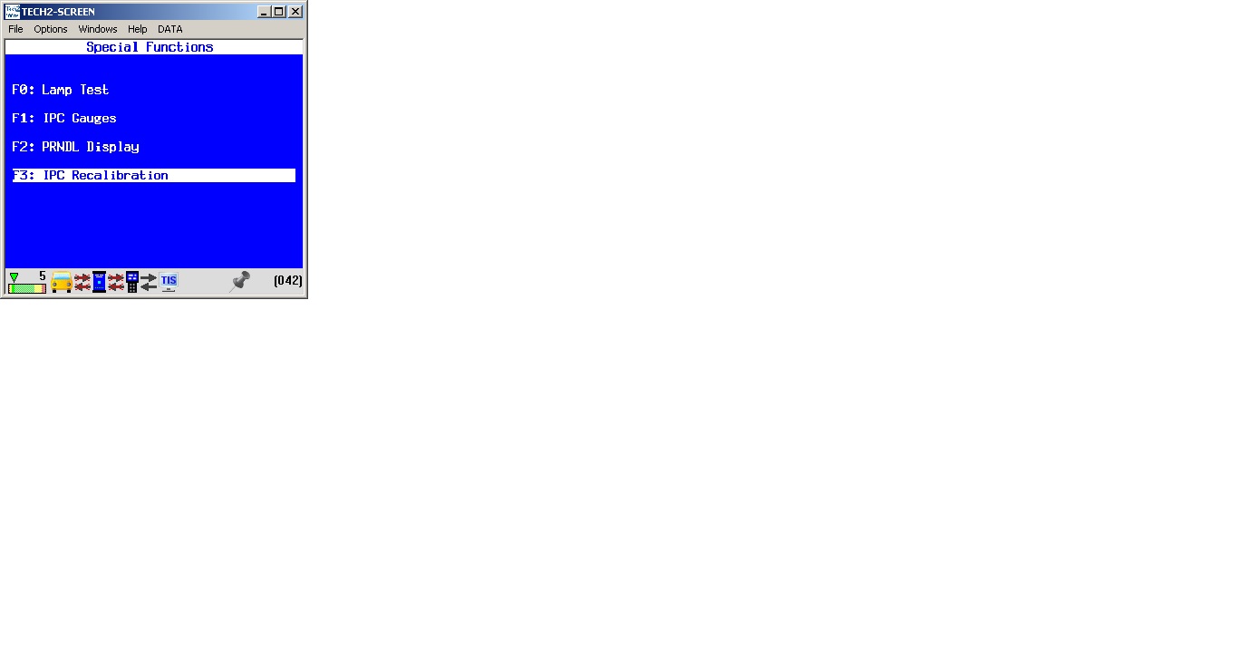

mileage usually is stored on eeprom, don`t expect to be on board mcu flash.
I looked at tech2 data for this dash, It doesn`t even have a mileage on the datastream[only trip data], It may be stored in bcm or pcm.
