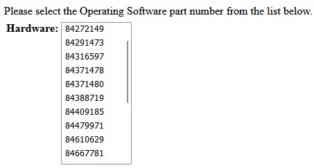

I’m on my ipad at the moment so I can’t check but.. 90% sure for IOR radios you’re supposed to do radio sps first, and then radio usb afterwards. It’s not one or the other it’s both and it’s supposed to be in a particular order and that order flip flops depending on the radio.. So you tried the other calibration in the SDM and it didn’t disable the buckle to drive and it also didn’t show up in the radio/vehicle settings to be disabled? I haven’t checked but it sounds like the radio usb files were the same between yours and the donor vehicle. What about the other calibrations using radio sps? You might need those to have the buckle to drive option to show up? This is all unknowns to me but I’m just throwing ideas to see if one of them sticks.. next steps would be checking bcm calibrations between the donor and yours excluding the calibration changed for rvs. Then maybe ecm cals and lastly the tcm cals maybe? It’s going to start to get to more of a pita with subtle differences in the cals for rear end ratio, possible fog lamps or cruise control differences, etc.. if you find a different cal you’ll want to research any differences in the truck vins that may be the reason why besides the buckle to drive option.. someone else might be able to break down the actual code in each module but that is way over my head. I’m more of mod a file 100 times trying to find the remote start timer kind of guy, lol
Re: Fleet Vehicles and Buckle to drive on newer GM vehicles (2021 Colorado LT 2.5L)
Well I did USB first and then 2 months later, the SPS update for IOR, looking at the cals I don't think much has changed from production with the exception of some OTA update changes in the common cal, so I don't think I was missing anything.
I've uploaded the radio updates to my gdrive so you can see what I'm talking about the SPS update is only the calibration files and utility file (01 skipped per the sps.log). The calibration bins all contain XML files. Some of the settings might be easy to figure out, like equalizer you could reset defaults and go through the list of settings matching them to the values in the xml file.
Can also eliminate some cals, as I don't think buckle to drive is going to be in "equalizer" for example.

So I was looking into the radio to possibly enable the menu item with the on/off switch. Might still go that route if Techline refuses to help.
I originally took this to mean its available in sps for anyone during setup of the module, but I'm now thinking this is an optional calibration that needs to be assigned by Techline. I tried calling them today, left my number, two hours later they call back and immediately hang up.https://www.gmupfitter.com/wp-content/uploads/2021/07/21_Canyon_Colorado_Electrical_Body_Builder_SM_en_US_U_2020MAY19.pdf wrote:The Safety Belt Assurance System can be disabled

Differences in radio cals are below.. OS is the same between all 3 trucks..
Radio cal is different from yours to donor trucks.
yours is 84919661 and both donor's have 84580617
Rear view camera cal is different.
yours is 84213979 and both donor's have 84268240
Telematics is different.
Yours = 84585020 and donors are 84514633
The rest are the same in one but different in the other donor truck. Don't discount rear view camera or telematics cals as they don't always make sense.. Why is RVS enabled or disabled in occupant display cal segment?
Doesn't look like I have any of the other donor trucks cals for those different ones but I'd try one at a time or all 3 at once, either or. Maybe try all 3 to see if it fixes it, then remove one at a time to find the one that enables the menu?
Just noticed yours has UIJ for 8" scree and the others have UIR for 7" so thats going to make differences too.. damn.
OK. check out vin 1GCGTCEN9M1132525
IOR with UIR and UE1 for onstar and it has the different T7Z buckle to drive.. Only common different cal is rearview camera segment.
all 4 have UVC for rear camera.
I would try programming the radio with that different 84268240 rearview camera segment but with everything else the same..
