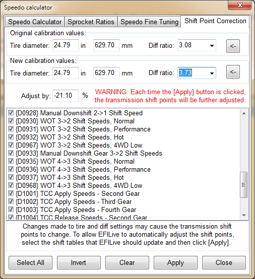

Hey Ken
I put your numbers in and the speedo is right but gear changes are out a fair bit
For instance the gears are hanging
Seems the output shaft pulse per revolutions plays a big part in shifts
Speedo, pcm and gps all match and i don't know where to go from here

darky82 wrote: Thu Nov 28, 2024 9:27 pm Hey Ken
It does.
Here's the screenshots of all the trans settings it alters ( by -21.10%) to suit the new diff ratio.

Thanks very much
I will change them all and see how it goes
