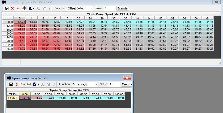

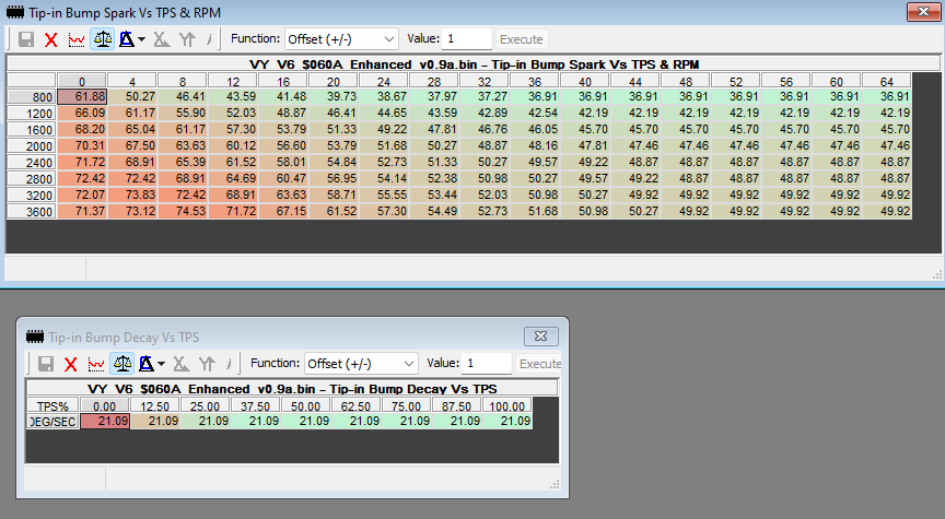

Some more changes from s1 to s2. Theres also changes in the injector multiplier, And even things like the normal & performance upshift pressures or tcc ect. Another thing I noticed is burst knock seems to be active on series 2 vy. But those address's are wrong from what I can tell. Burst knock is actually off for both. So all this gives an indication of tables and things that were changed from the factory, on the same pcm, same engine ect. Just obviously more emissions related with the extra cats ect.

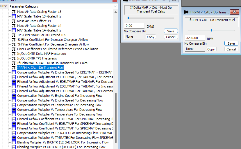

I remember ages ago logging maf and afr’s after stomping the throttle, and remember there was a delay in maf readings. Just wondering if those maf tables I shared earlier have something to do with that. Probably the reason why the map based ecm’s feel more responsive on the eco? There’s maf vs coolant, tps and rpm ect ect. And no one seems to talk about them. Even a google search doesn’t bring up much results.
Wade

If you look at the scalers before those maf tables there related to transient fuel. So I find that very interesting.

I think that is also a trait of MAF based EFI tuning. Run everything at stoich until you hit PE and then it's throw everything at it.
I do think though by VY Holden really had it figured out. I remember been in a friends VY when we still had our old VS and it seemed worlds apart.
