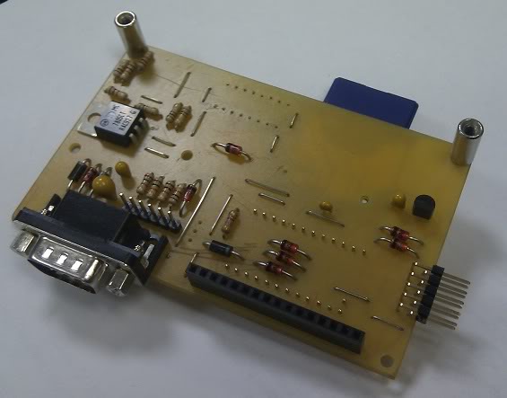

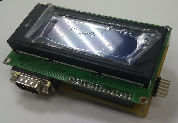

Firmware is progressing, the ADX parsing and XDL generation code is working heaps better. Can have a full ADX (dash, monitors etc) on the SD, in the description of 12 items you put the number 1-12 and it will display them on the LCD as live data during logging/recording. Then all you do is chuck the SD card in to your PC, open TP5 and load the ADX and XDL on the memory card.
Have also made up a new proto board that has a few changes and also includes the Teensy 2...
Re: ALDL Logger
looks just about the perfect size for my suction cup universal device holder on my windscreen
Re: ALDL Logger
nice work VL400, looks very neat and compact thats for sure!
good idea with the 1-12 on the adx descriptions, means minimal screwing with ADX's!
