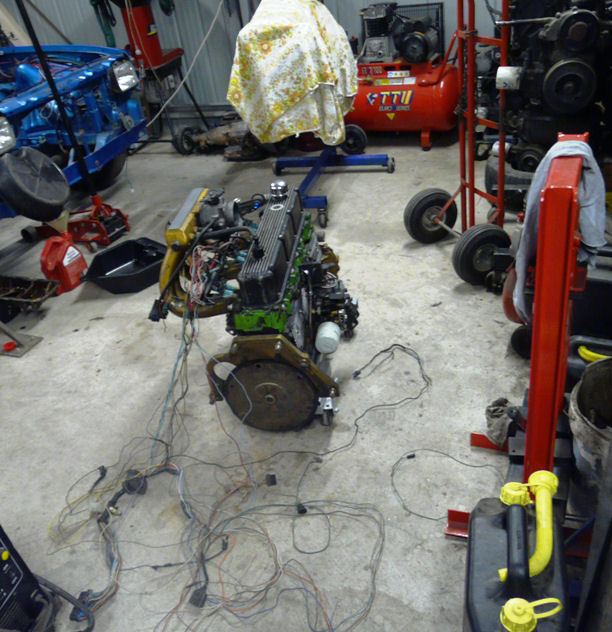

i have started on the wiring for the gemini .... :comp: i didn't use the loom from the torana cause i am selling that to my mate, also i wanted to make another loom and do it better than the first attempt.
so i got out my spare 202 on the trolley and fitted up my manifold and got into throwing wires around!
in preparation for $12P release i am making a few changes, removed the knock sensor wire and its being re-pinned to work for the wideband input to the ECM and i'm thinking i'll wire it into one of the spare wires on the plug thats under the dash, also thinking i wont bother with a narrow band o2 sensor and i'll just use the analog output of the wideband to fake a narrow band signal .... seeing how this car will spend most of its useful time in open loop mode i figure a narrow band is a bit useless
Re: My Delcoed Rides

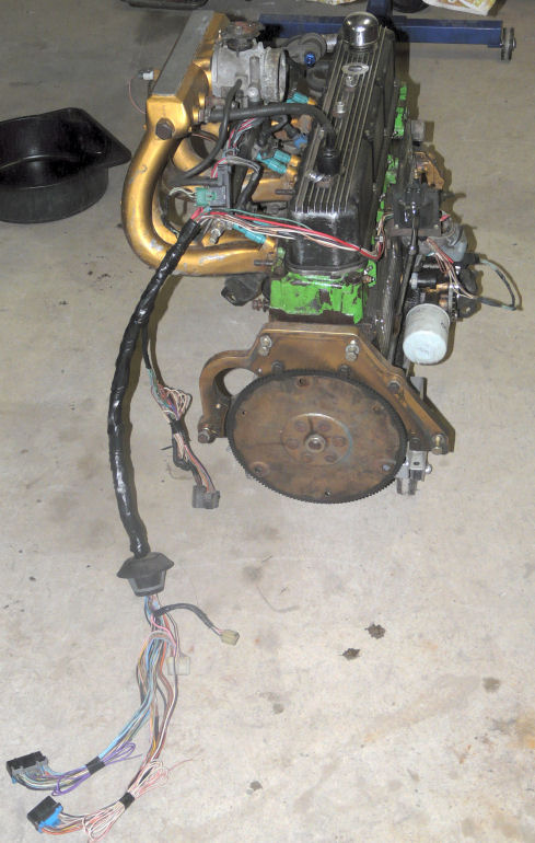

from this ^^^^^^^^^^
to this overnight!!
if only it actually happened in my sleep :D
pretty much got it all sorted ... need to get some lugs that fit over 3/8 bolts for one of the earths and i also need to get the plugs for the camira coil .... i've left some of the wiring uncovered because i want to run tacho, coolant gauge, oil pressure and stuff like that all in the one loom so i have to get them out of the gem and add them in .... as far as the efi side of it goes though im on the home stretch!
