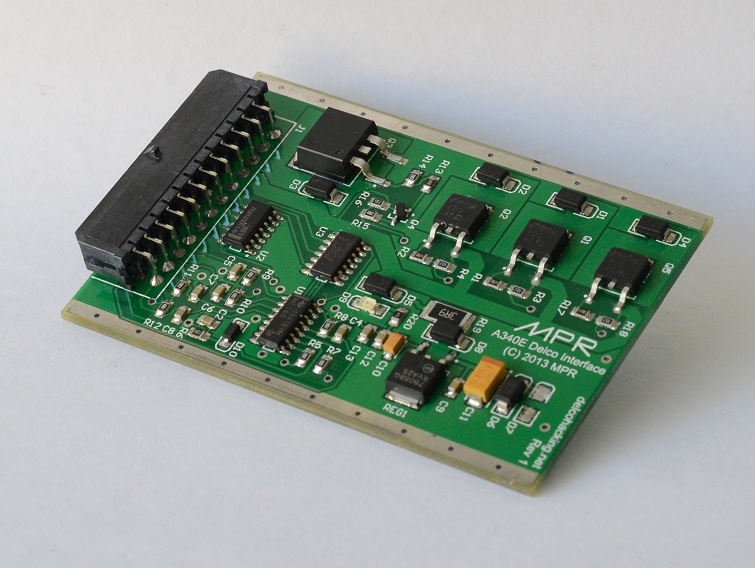

Finally got around to building the trans interface board. It takes the delco signals for the two shift solenoids and converts them to high side drivers (the toyota trans needs 12V switched unlike the delco switching ground), a reverse lights output driver, and a TCC driver (the delco cant supply enough current). It also takes the A340E Toyota shifter switch outputs (a switch for every position) and converts them to the 3 delco range signals it uses to interpret the shifter position.
A340E Rev1 SM.JPG (175.25 KiB) Viewed 6951 times

Holy crap there's some smarts right there, right where the Delco needed it!
