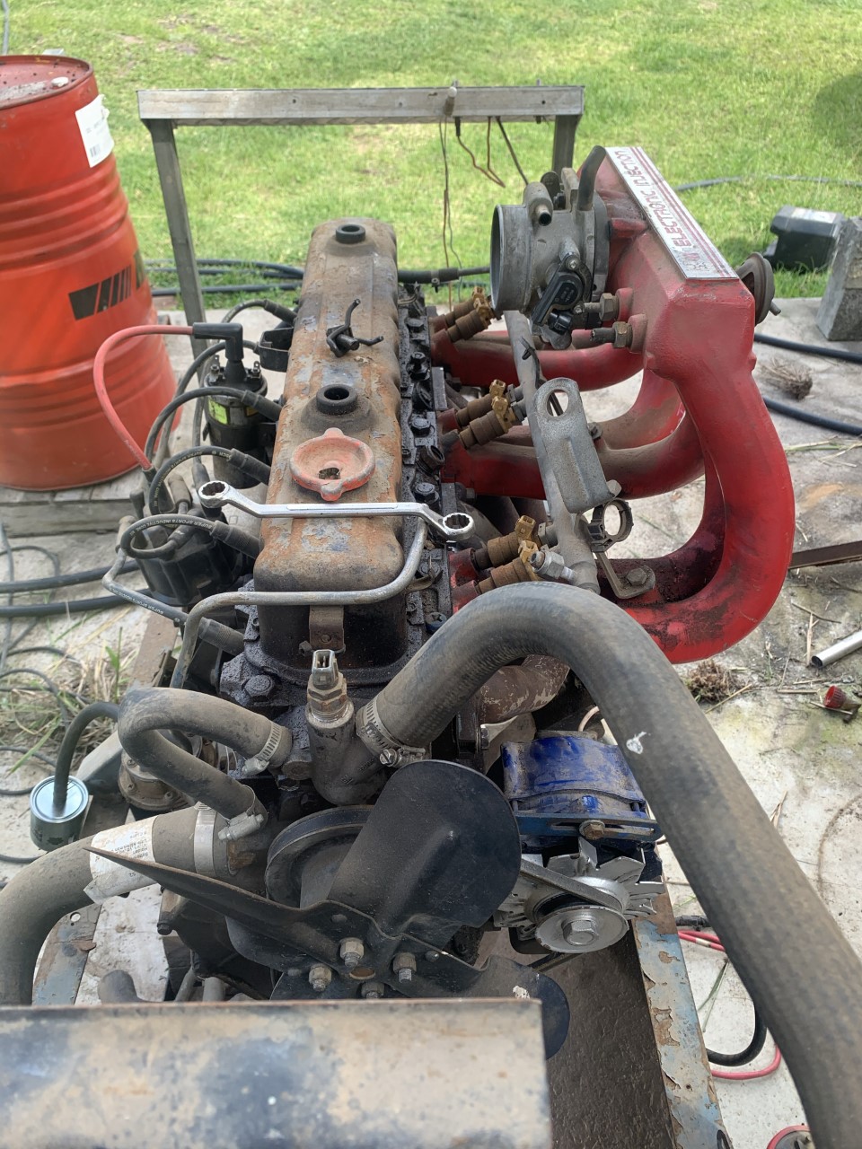

started my 808 swap. dizzys all locked, stuck an ecotec throttle body on the manifold with the flange off a vn elbow as a spacer
n13 loom is about to get stripped and routed, and 2 injector plugs added
id post a few photos but since photobucket wont work, and i cant work out how to go straight from my phone or computer

scrapped the n13 loom, had way to many repairs in it, now have a v6 loom spread across the bench
trial photo
